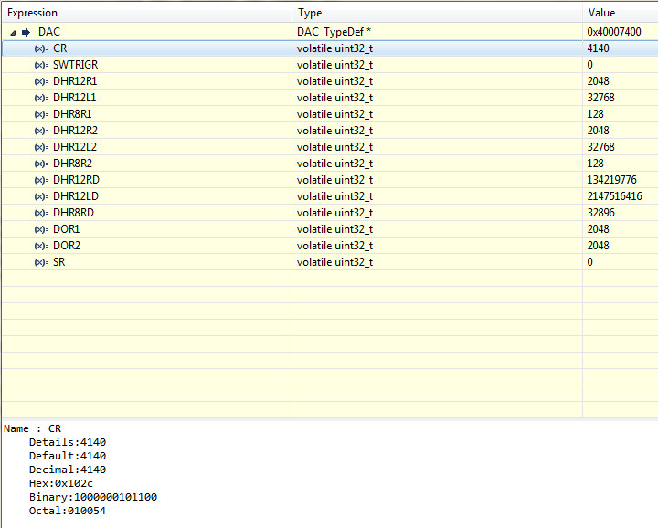

‎2021-11-26 5:54 AM
My Q (Q=question, indeed) centres on whether DAC2 needs to be in any special mode, in order to receive the top half of the 32 bit value.
The way the 32 bit mode works (I have spent hours googling of course, but most example online are useless) is that only one of the two DACs need to trigger the loading process. The other DAC seems to "just work" when the 32 bit value is loaded into DHR12RD.
In this case (a waveform generator) TIM4 triggers DAC1, and DAC1 triggers DMA1 to load the 32 bit value, which incidentally is also loaded into DAC2.
As I said, I have a working system but don't want to do something which could break.
After the above init, this is in there
https://peter-ftp.co.uk/screenshots/202111264713675013.jpg

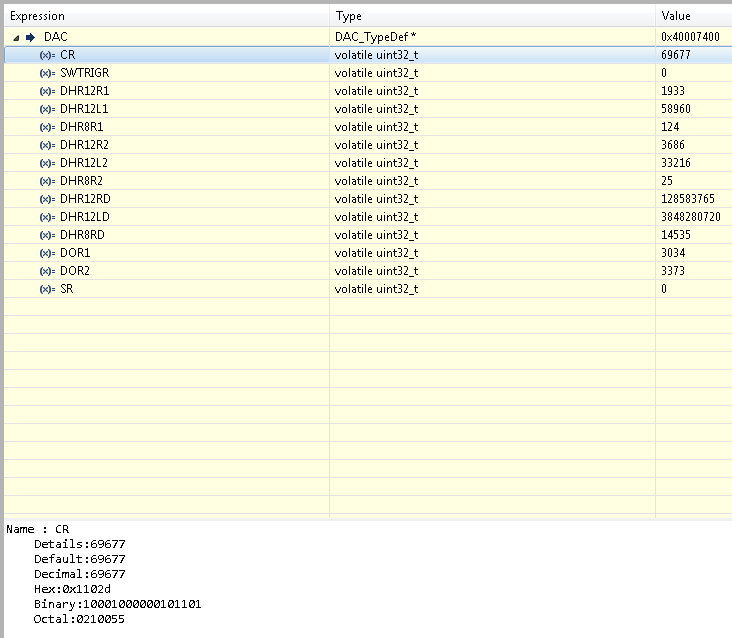

and after
DAC->CR = (1u << 12) // DMAEN1=1 - DAC1 DMA1 enabled
|(5u << 3) // TSEL1=5 - DAC1 trigger source Timer 4 (Timer 4 TRGO event)
|(1u << 2); // TEN1=1 - DAC1 trigger enabled
this is what is in there
https://peter-ftp.co.uk/screenshots/202111262013685213.jpg
Thank you for looking at it.
To me it makes sense that DAC2 config is irrelevant so long as it is enabled.
‎2021-11-26 6:22 AM
You can copy/paste pictures here.
OK so the latter one:
is taken from the state when DMA works and generates varying output on both DAC1 and DAC2?
That's strange as DAC_CR=0x102c thus both DACs are disabled ...
