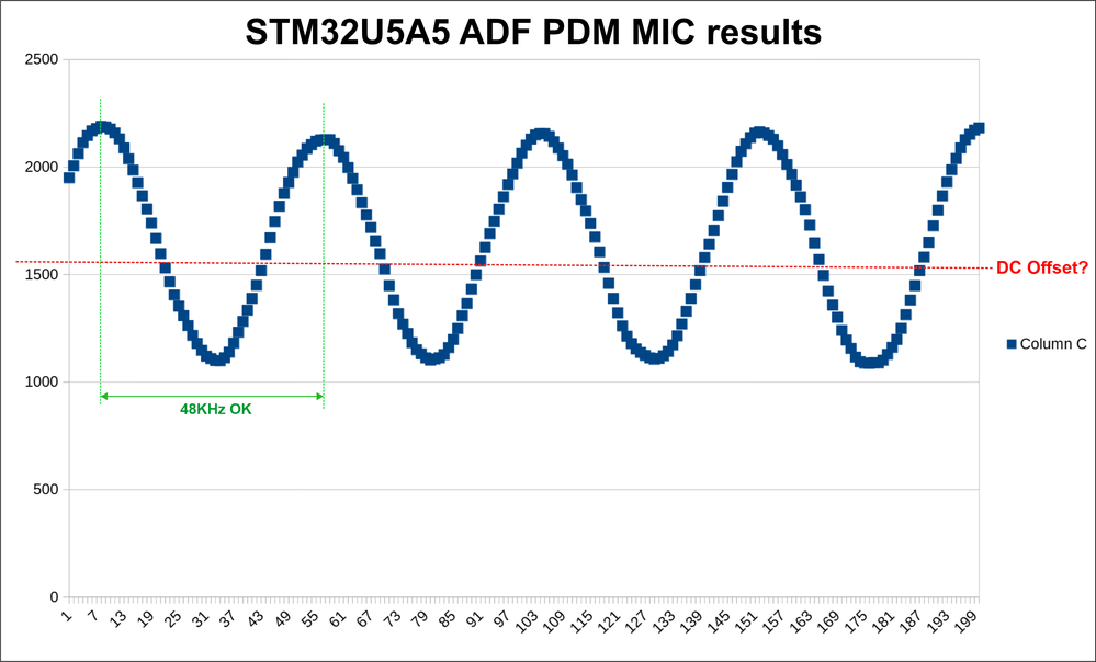

  2. I have debugged the code and I have dropped the buffer content displayed in debugger into Excel/LibreOffice (to get a graph):
    I was playing a 1KHz sine wave from smartphone speaker and I can see it - cool, the PDM MIC works and gets the audio signal.
    But:
    a) There is a DC offset (around value 1600). I see this DC offset also with a quiet signal (just ambient noise):
        all values are around 1600 (plus/minus noise).
    b) Where is this DC offset coming from?
    c) How to set the output data size, e.g. 16bit signed PCM?
       The buffer is defined as: int16_t RecBuff[REC_BUFF_SIZE * 2U];
       Is there a config to force 16bit signed? (and why I never get the full swing?, or this DC offset?
       My gain setting is 0.)

I've found a way to get rid of the DC offset: enable the High Pass Filter on ADF:
  AdfFilterConfig0.HighPassFilter.Activation = ENABLE; 	//DISABLE; this seems to remove the DC offset
Now it works fine, except:

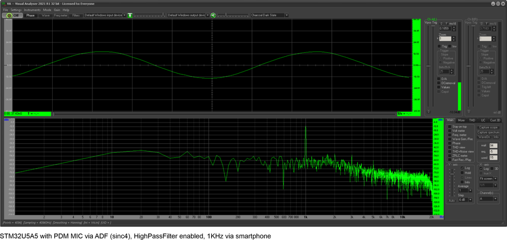

And: it is much better as any software based PDM2PCM approach (e.g. using this SW filter on a Portenta H7).
I do not see the harmonics (artefacts), it sounds much better, just the volume level is lower (but I can correct in the SW, in the "digital domain", e.g. scaling before forwarding the PCM sample values).
Here, how it looks like with ADF as PDM MIC input and a 1KHz sine wave from smartphone (pretty good):
