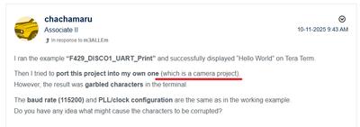

I ran the example project and successfully displayed “Hello World” on Tera Term.
Then I tried to port this project into my own one.
However, the result was garbled characters in the terminal.
The baud rate (115200) and PLL/clock configuration are the same as in the working example.
Do you have any idea what might cause the characters to be corrupted?

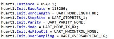

static void MX_USART1_UART_Init(void)
  huart1.Instance = USART1;
  huart1.Init.BaudRate = 115200;
  huart1.Init.WordLength = UART_WORDLENGTH_8B;
  huart1.Init.StopBits = UART_STOPBITS_1;
  huart1.Init.Parity = UART_PARITY_NONE;
  huart1.Init.Mode = UART_MODE_TX_RX;
  huart1.Init.HwFlowCtl = UART_HWCONTROL_NONE;
  huart1.Init.OverSampling = UART_OVERSAMPLING_16;
  if (HAL_UART_Init(&huart1) != HAL_OK)
    Error_Handler();

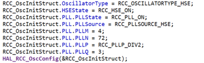

static void SystemClock_Config(void)
  /* Enable Power Control clock */
  __HAL_RCC_PWR_CLK_ENABLE();
  /* The voltage scaling allows optimizing the power consumption when the device is
     clocked below the maximum system frequency, to update the voltage scaling value
     regarding system frequency refer to product datasheet.  */
  __HAL_PWR_VOLTAGESCALING_CONFIG(PWR_REGULATOR_VOLTAGE_SCALE1);
  /* Enable HSE Oscillator and activate PLL with HSE as source */
  RCC_OscInitStruct.OscillatorType = RCC_OSCILLATORTYPE_HSE;
  RCC_OscInitStruct.HSEState = RCC_HSE_ON;
  RCC_OscInitStruct.PLL.PLLSource = RCC_PLLSOURCE_HSE;
  RCC_OscInitStruct.PLL.PLLM = 4;
  RCC_OscInitStruct.PLL.PLLN = 72;
  RCC_OscInitStruct.PLL.PLLP = RCC_PLLP_DIV2;
  RCC_OscInitStruct.PLL.PLLQ = 3;
  HAL_RCC_OscConfig(&RCC_OscInitStruct);
  /* Activate the Over-Drive mode */
  HAL_PWREx_EnableOverDrive();
  /* Select PLL as system clock source and configure the HCLK, PCLK1 and PCLK2
     clocks dividers */
  RCC_ClkInitStruct.ClockType = (RCC_CLOCKTYPE_SYSCLK | RCC_CLOCKTYPE_HCLK
		                        | RCC_CLOCKTYPE_PCLK1 | RCC_CLOCKTYPE_PCLK2);
  RCC_ClkInitStruct.APB1CLKDivider = RCC_HCLK_DIV2;
  RCC_ClkInitStruct.APB2CLKDivider = RCC_HCLK_DIV1;
  HAL_RCC_ClockConfig(&RCC_ClkInitStruct, FLASH_LATENCY_5);

Fig.1 Display result
Fig.2 PLL configuration
Fig.3 Baud rate (115200)  on Teraterm
Fig.4 Baundrate on project

Getting garbled characters (almost) certainly means that the baud rate is wrong.
So check your assumptions carefully: eg, is your clock frequency really what you think it is ?
Use an oscilloscope to see what baud rate is actually happening on the wires.

You've omitted this information:
How did you port the USART example to your Camera project?
