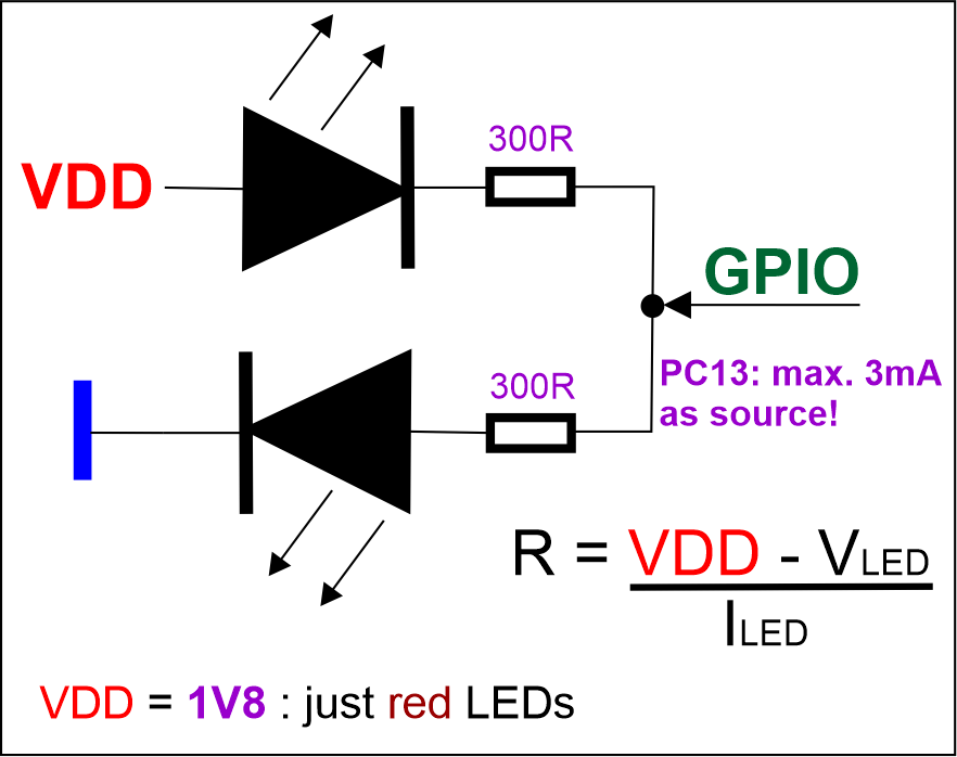

Three states on a single GPIO pin with two LEDs is possible.

One GPIO pin for three states
  • Use a Dual-LED with two LEDs, "anti-parallel"
  • One LED is on, if GPIO is set low (acting as a sink)
  • The other LED is on, if GPIO is set high (providing a source)
  • Both LEDs are off, if GPIO is configured as an input (no current)
Remark:
if you run VDD as 1V8 (as I do) - you can only use red LEDs! The forward voltage of a green LED (or a blue one) is above 1V8 - it would never go on.  With 3V3 you can use any combination of colors (maybe not white).

If you want to create a fourth state with one GPIO and two LEDs:
  • generate a frequency (toggling the GPIO fast enough, e.g. with 20 Hz or faster) - both LEDs are on

Yes, I know: datasheet says: PC13,,,PC15 can just source 3mA in total (as sum). And it should not be used to drive LEDs (directly), even I do.
But I made sure the current is below 1mA (1V8 with 300R).
I decided to use PC13 as LED because it does not have any other useful ALT function (e.g. SPI, I2C, ...).
BTW: I have implemented the "fourth state" for my LEDs:
  • set a global variable to enable "both LEDs"
  • use this variable and when set: toggle via SysTick or TIM6 INT the LEDs (they toggle between both due to fact that GPIO for both is sink vs. source)
This results in having both LEDs on (toggling so fast that it looks like both are on, greater 20Hz for human eyes). It does not need a PWM.

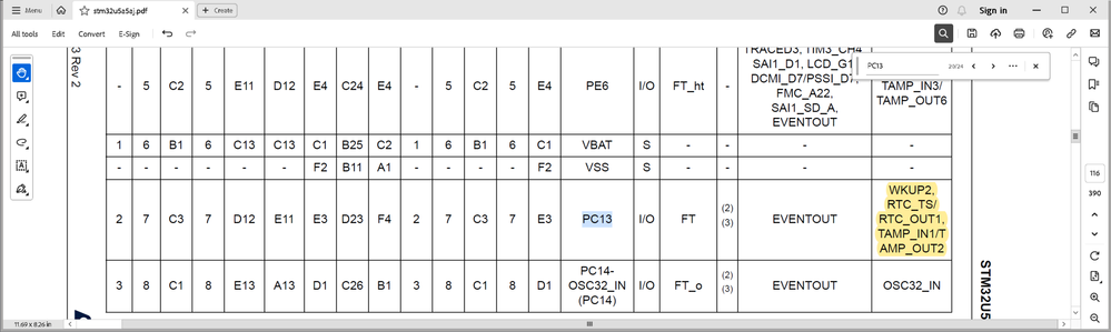

Here the functions for PC13.
How to configure/enable the "additional functions"? (only EVENTOUT is possible for me)

> how to configure PC13 for RTC_OUT1? I have not found an ALT setting to do so?
See Table 628. RTC pin PC13 configuration(1) in the reference manual for how PC13 is configured for RTC options. It is in "Additional functions" because it is not defined as an "alternate function" through the normal means (GPIO_AFRx registers). It is controlled with the RTC registers.
By default, it should be a GPIO pin as far as I can see. Analog mode, high impedance.
