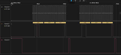

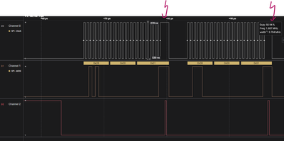

I am using an STM32H523 MCU where I transmit some data via SPI (master tx only) in blocking mode.
In debug build the SPI behaves as it should be and everything is fine.
In release build the SPI CLK line remains high for too long, after the last bit of a transmission has been sent.
This results in the (software) CS line going high before the CLK returned to 0 (the DAC7562 slave does not like that)
How it looks like in Release:
How it looks like in Debug (correct):

It's probably floating which would be apparent on an analog capture.
> SPI_MASTER_KEEP_IO_STATE_DISABLE
Set this enabled if you want the pins to keep their state.

Yes, thanks! Have a nice weekend
