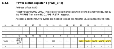

I am using the  Nucleo-L433RC-P board and have configured pin PC13 as SYS WKUP (for the blue top button).
How can I read the state of this pin when the processor wakes up, because HAL_GPIO_ReadPin will not work.
I am sure I used a function or macro to read the state of this pin before, but can't remember how I did it.
I need to distinguish between an RTC wake or a pin wake from shutdown.
I use wake markers stored in an RTC backup register to detetc an RTC wake.  I write to the backup register just before calling shutdown in the function SCH_mcuSleep....

The pin needs to be initialized as an input pin before HAL_GPIO_ReadPin will read its state. By default, the pin is in analog mode.
If a wakeup pin caused the wake up, a flag is set in RCC->SR1. This is latching--it doesn't reflect current state of the pin.
Thanks TDK
How do I read the  RCC->SR1 register ?  Is there a macro or function ?
You can just read it and look for the corresponding bit:
if (RCC->SR1 & RCC_SR1_WUF1) {
Or you can use the READ_REG macro:
if (READ_REG(RCC->SR1, RCC_SR1_WUF1)) {
Of if you prefer HAL:
if (__HAL_PWR_GET_FLAG(PWR_FLAG_WUF1)) {
All equivalent.
