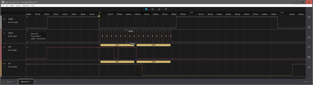

Why is NSS floating between transactions?
So far, fine. But why is SPI1_NSS released between transactions?
Even I configure with GPIO_PULLUP for PA15 - it seems to be floating (going to low on scope). Just an external pull-up fixes the issue (to keep NSS high all the time, what I want to see).

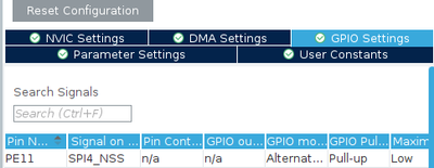

AScha.3
March 17, 2024
Maybe because you didnt "tell" Cube , what you want ?
you can set pin pullup:
and/or keep line state activ:
+ then : its still not doing, as you want it ?
