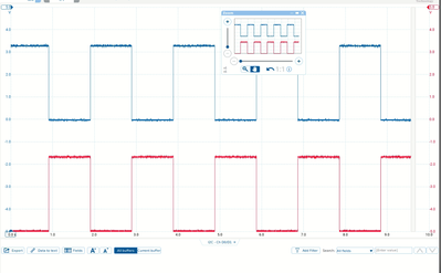

ahsank
I have recreated new project using cube IMX and use I2C2 PF0 and PF1 but not getting any output , I have been using picoscope to see it
ahsank
if i just toggle PF0 and PF1 I am getting correct output but If I send data using i2c using following main while loop and obv configuration done by cube IMX

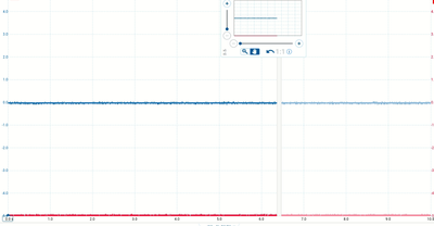

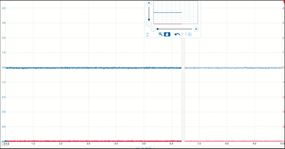

its a NUCLEO-U5A5ZJ-Q board
I have tried by enabling and disabling pullups but no success
The configuration when pullup enabled is as follow
HAL_GPIO_WritePin(GPIOF, GPIO_PIN_0|GPIO_PIN_1, GPIO_PIN_RESET);
/*Configure GPIO pins : PF0 PF1 */
GPIO_InitStruct.Pin = GPIO_PIN_0|GPIO_PIN_1;
GPIO_InitStruct.Pull = GPIO_PULLUP;
HAL_GPIO_Init(GPIOF, &GPIO_InitStruct);
the wave for SDA and SCL is shown as below
@TDK
Not sure I understand this test. You've initialized PF0 and PF1 as GPIO outputs and set them to a low level. They look to be low on your scope. That all is functioning as expected, yes?
If you want PF0/PF1 to be I2C pins, you need to initialize them as such. CubeMX should generate the code to do this for you.
