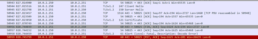

I am currently implementing an HTTPS server using mbedTLS 3.6.5 and LwIP on an STM32H7S7L8 platform running FreeRTOS.
Our mbedTLS configuration  are fully functional, as we already have a stable, working TLS implementation on an MQTT client using the same stack.
However, we are encountering an issue during the TLS Handshake phase on the server side after configuring the client sockets to non-blocking mode (O_NONBLOCK). While the listening socket correctly accepts incoming connections, the handshake loop fails.
I have attached the relevant snippet of our server thread implementation, including our I/O callbacks.
Could you please review our non-blocking I/O logic and handshake loop to see if we missed a specific configuration requirement or state handling for mbedTLS 3.x in server mode?

openssl s_client -connect 10.0.2.251:443 -debug -tls1_2
Connecting to 10.0.2.251
CONNECTED(00000190)

static int mbedtls_lwip_send(void *ctx, const unsigned char *buf, size_t len) {
    int fd = *((int *)ctx);
    int ret = lwip_send(fd, buf, len, 0);
    if (ret < 0) {
        /* If the socket is non-blocking and the operation would block */
        if (errno == EWOULDBLOCK || errno == EAGAIN || errno == EINPROGRESS) {
            return MBEDTLS_ERR_SSL_WANT_WRITE;
        return MBEDTLS_ERR_NET_SEND_FAILED;
    return ret;
/* --- Custom Receive Callback for mbedTLS (Non-blocking LwIP) --- */
static int mbedtls_lwip_recv(void *ctx, unsigned char *buf, size_t len) {
    int ret = lwip_recv(fd, buf, len, 0);
    if (ret < 0) {
        /* If the socket is non-blocking and no data is available yet */
        if (errno == EWOULDBLOCK || errno == EAGAIN) {
            return MBEDTLS_ERR_SSL_WANT_READ;
        return MBEDTLS_ERR_NET_RECV_FAILED;
    } else if (ret == 0) {
        /* Connection closed by the remote client */
        return MBEDTLS_ERR_NET_CONN_RESET;
    return ret;

    /* Main Server Loop */
    while (1) {
        mbedtls_ssl_session_reset(&ssl);
        /* Block and wait for an incoming client connection */
        client_fd = lwip_accept(listen_fd, (struct sockaddr*)&client_addr, &client_len);
        if (client_fd < 0) {
            osDelay(10);
            continue;
        /* Set the client socket to NON-BLOCKING mode */
        int flags = lwip_fcntl(client_fd, F_GETFL, 0);
        if (flags >= 0) {
            lwip_fcntl(client_fd, F_SETFL, flags | O_NONBLOCK);
        /* Bind the LwIP Socket file descriptor to the TLS Bio interface */
        mbedtls_ssl_set_bio(&ssl, &client_fd, mbedtls_lwip_send, mbedtls_lwip_recv, NULL);
        printf("Executing TLS Handshake...\n");
        while ((ret = mbedtls_ssl_handshake(&ssl)) != 0) {
            if (ret != MBEDTLS_ERR_SSL_WANT_READ && ret != MBEDTLS_ERR_SSL_WANT_WRITE) {
                printf("Critical error during Handshake: -0x%04X\n", -ret);
                break;
            /* Socket is non-blocking: yield to FreeRTOS scheduler while waiting for I/O */
            osDelay(5);
        if (ret == 0) {
            printf("TLS Handshake Successful!\n");
            https_server_serve(&ssl);
            /* Securely notify and close the TLS connection layer */
            do {
                ret = mbedtls_ssl_close_notify(&ssl);
            } while (ret == MBEDTLS_ERR_SSL_WANT_READ || ret == MBEDTLS_ERR_SSL_WANT_WRITE);
        /* Tear down the underlying client TCP network socket */
        lwip_close(client_fd);
