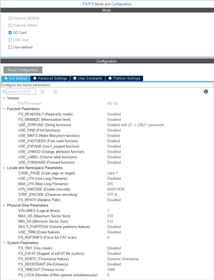

in sd_diskio.c. The project is generated using STM32CubeMX on v1.13 of the processor's firmware. I have tried various methods of troubleshooting this including:

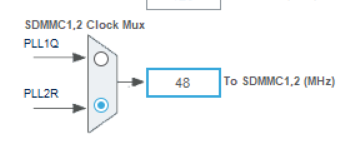

Changing my clock source from PLL1Q running at 64MHz to PLL2R running at 48MHz

disabling LFN functionality to simplify the code execution

FATFS settings with DMA template enabled in advanced settings

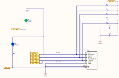

if perfect, try 4bit mode . (I had problems even with 30mm too much wire...) so how looks your system ? show pic.
Running in 1bit mode, no DMA, at 9.6MHz returns inconsistent FR_DISK_ERR on f_open and f_reads very quickly. The circuit for the SD card is as follows:
The pullups are 47k.

1. How long are the lines CPU to SD-card?
2. Pin mode/ speed of pins for SD-card?
3. Supply at 3v3 is clean, no spikes?
Maybe cap could help, I have 10uF cer cap close to the SD-card.
4. Clk speed for card, I use 100Mhz , div 1, so 50M for SD-card, maximum here.
1. the SD traces are only about 13mm from MCU to SD card slot
2.
3. Yes

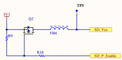

I could try tacking a cap to SD_VCC. This is the circuit that provides power and allows me to toggle power for a hard reset:
I understand that the SD card not working properly in 1b mode points to a hardware issue, however, this is not the first SD card/implementation that I have worked with as I use them quite regularly on other boards. I am only really having problems on this processor specifically between 2 different boards specifically using the H7 processor. I feel like I might be missing something in software that I am not considering.
Ok, but pin speed could be a problem;
try medium or medium/high and pullups ON on all lines to card.
At high speed these CPU pins switching so fast, that reflexions and ringing even on short tracks can cause big problems, try slow ...as possible, to rule out these kind of problems.
And clock for sdmmc module?
I will run tests at medium with pull ups on all of the lines. Most lines already have an external pullup.

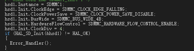

Fed clock to SDMMC is 48MHz
with a 4 for clock div for current testing:
I have tried 0-4 for clock div to be within "standard" operating speeds and safe operating speeds for SD cards.
