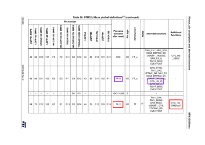

I have a U599 and would like to use the PA11 pin as an input with a pull-up. I've set the CR1_FORCE_USBPWR, USBPWREN, and VDD11USBDIS bits. However, the pull-up voltage only reaches 1.21V in this configuration. The pin works fine as an output.

What happens if you remove al the code related to USB and PWR and leave just the GPIO programming?

then the voltage only goes up to 0.7V.

Could you give us more information about the USB config when it was enabled?
I'm asking this because suspect that this is related to the limitation when USB is enabled (OTG_GCCFG.PWRDWN=1) the GPIO pin with the OTGx_ID function enables an internal pull-up for ID pin detection and when that function is no anymore required and you want to re-program it as GPIO, this will not disable the “ID” pull-up already described and this could corrupt the expected level.

Hi @Sarra.S ,
Note, that PA11 which is the pin in question, is *not* OTG_HS_ID; it's OTG_HS_DM i.e. one pin of the transceiver itself:
PS. The (boot) after the signal name is very confusing. Can it please be removed, and replaced by footnote?
