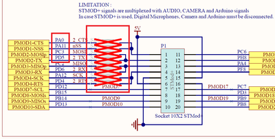

On the STM32H7B3I-DK, several STMod+ signals share two GPIO options (e.g., PA11/PA0, PC3/PD5 for SPI2/USART2). Even when I configure only one of the shared pins as a simple GPIO (e.g., output or input with pull-up), it doesn’t function — no toggling, no input reading, and no internal pull-up.
I've:
  • Disabled conflicting peripherals (USB, SPI2, USART2, etc.)
  • Verified GPIO clocks and init code
  • Tried minimal code to toggle pins
  • Confirmed it’s not a code or hardware mistake on my side
Is there something board-specific or internal (e.g., STMod+ mux, hidden peripheral lock) that blocks these pins?
Thanks,
mƎALLEm
Hello @Ghaith12 and welcome to the community,
Did you check the schematic of the board especially the STmod+ connections?
PA11/PA0, PC3/PD5 are disconnected by default from P1 connector. You need to solder the related solder bridges SB6 to SB9:

Hey, @mƎALLEmthanks a lot for the quick help!
You're absolutely right — I checked the schematic and saw that PA11/PA0 and PC3/PD5 are disconnected by default on the STMod+ connector. Didn't realize SB6 to SB9 needed to be soldered manually — that totally explains why nothing was working even though the config was correct.
Really appreciate you pointing that out! I’ll solder the bridges and test again.
