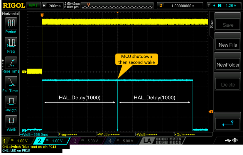

I am using the NUCLEO-L433RC-P with the blue top switch (pin PC13) configured as a wake pin.
When the switch is pressed, the MCU should wake, then turn the LED on, then shutdown.
But for some reason the MCU wakes twice as observed by the following behaviour:
  1. Switch pressed
  2. MCU wakes (LED turns on)
  3. MCU shuts down (LED turns off)
  4. MCU wakes again (LED turns on)
  5. LED finally shuts down (LED turns off)
This happens even though the switch is only pressed once.
The switch has RC filters so its not a debounce issue, especially as it happens even if the switch is held down.
My function Enable_PC13_Wakeup() clears flags etc before shutdown, so I don't understand why the MCU is waking twice.
Source code is below...

Strangely... and I don't know whether this might be a clue... when debugging there is only one wake cycle.  The issue with 2 wake cycles only happens when not debugging i.e. in standalone
It also only happens when the switch is held down, not if the switch is pressed then released.
Below is the scope trace showing the switch (channel 1 yellow) and LED (channel 2 cyan).
With the switch permanently pressed, you can clearly see that after 1000ms that the LED turns off.  But then it turns back on again for another 1000ms (the second wake cycle which should not have happened).  After that the LED remains off.
The simplified software is below...

	HAL_GPIO_WritePin(STATUS_LED_GPIO_Port, STATUS_LED_Pin,GPIO_PIN_SET); 		// turn LED on
	HAL_Delay(1000);
	SCH_mcuShutdown();

void SCH_mcuShutdown (void){
	// write value to RTC backup register to indicate mcu was in shutdown
	HAL_RTCEx_BKUPWrite(&hrtc, RTC_BKP_DR2, WAKE_FROM_SHUTDOWN_WKUP);
	// disable RTC wakeup
	HAL_RTCEx_DeactivateWakeUpTimer(&hrtc);
	// enable pin wakeup
	Enable_PC13_Wakeup();
	// enable pull up resistor during shutdown for charger CE pin
	HAL_PWREx_EnableGPIOPullUp(PWR_GPIO_A, PWR_GPIO_BIT_8);
	HAL_PWREx_EnablePullUpPullDownConfig();
	// Call shut down
	HAL_PWREx_EnterSHUTDOWNMode();
// Switch PC13 back to wakeup pin (for shutdown mode)
void Enable_PC13_Wakeup(void)
	HAL_NVIC_DisableIRQ(EXTI15_10_IRQn);
	HAL_GPIO_DeInit(GPIOC, GPIO_PIN_13);
	__HAL_GPIO_EXTI_CLEAR_IT(GPIO_PIN_13);
	__HAL_PWR_CLEAR_FLAG(PWR_FLAG_WU);
	HAL_PWR_EnableWakeUpPin(PWR_WAKEUP_PIN2); // or PWR_WAKEUP_PIN2_LOW for falling edge
