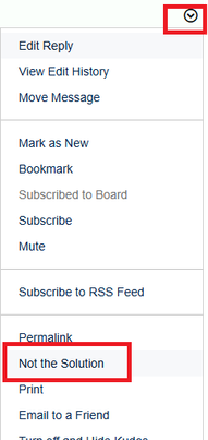

In next time please don't mark the solution as it was not solved. If it was mistakenly done, you can unmark it using this arrow:

@Dharmendra_Singh why are you accepting as solution each time I post a comment?
