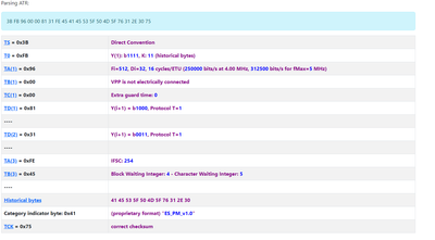

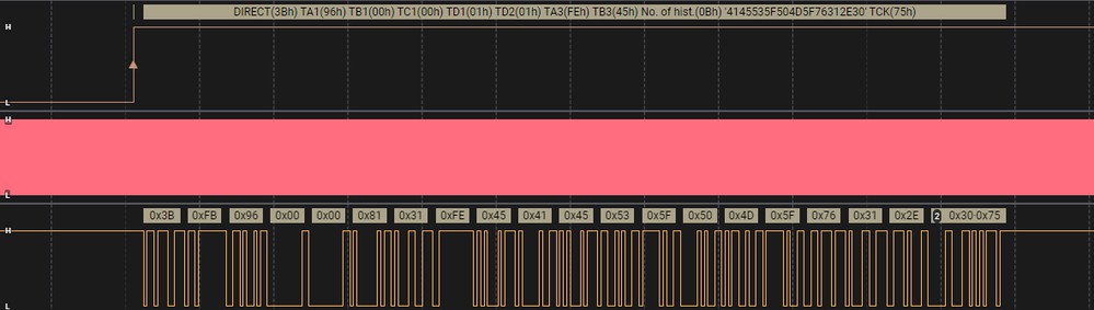

We are testing the STM32U585 Smart Card mode with clock and trying to connect with external SAM module. We are able to get the USART-ISO7816 frame format from the controller but we are unable to capture the ATR value from the module in a correct manner. From the logic analyzer with the setup connected we are getting correct ATR values but inside the controller the ATR values are in the wrong format. Following is the expected card ATR response:

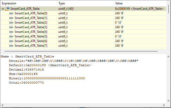

This waveform is obtained from the card reader connected to the STM32U585 board. and the ATR waveform is the correct format as described in the standards. the same signals we are capturing in the STM32U585 debug mode and getting the data as shown in the below figure.

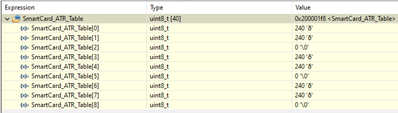

Values in SmartCard_ATR_Table are 240, 240, 0, 240, 240, 0, ... It seems values are 'noise'. The memory was not written and have previous values. How many bytes do you receive?
If this is not the case, maybe baud rate or smartcard clock are wrong. But I believe this is not the case due to the sequence 240, 240, 0.
The logic analyzer is configured with baud rate 9600 or it auto detects the baud rate?

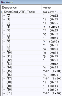

I have also tried with different microcontroller NUCLEO-STM32U575-Q board. With the configuration mentioned for (ComDMA) i.e 4Mhz @ 10752 bps. Still we are getting same data. PFA for the same.
Waveforms captured via logic analyzer
Data read from u575 STM board

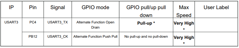

I wanted to know if you are getting this output by using ST8024 IC. As I have researched there is a 11k internal pullup on IOUC line. So can you please let us know what is the configuration done for the same.
This is my current configuration
