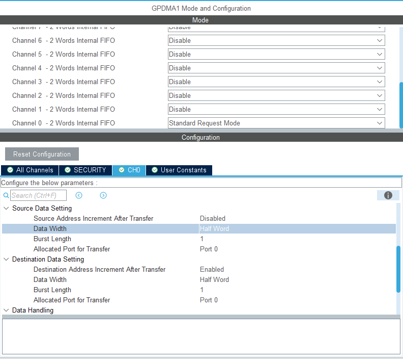

I have a board with a STM32U575RGTX CPU, and i use SPI1 with a 2.8" TFT ILI9341 Display.
I got problems with the GPDMA1 configuration, and need help.

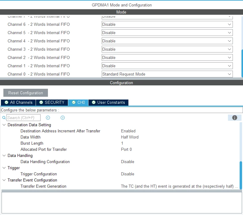

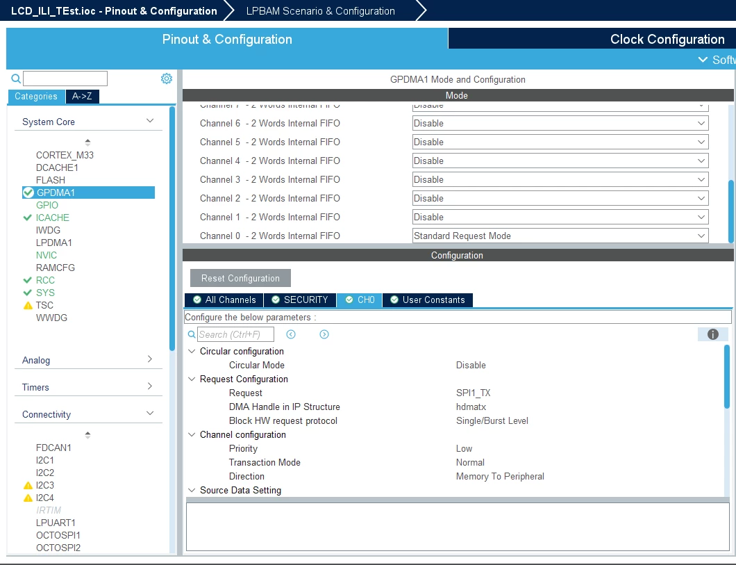

When i use HAL_SPI_Transmit_DMA, then the colors on the TFT are not correct (Red=Magenta,Green=Green,Blue=Black), if i change the code to HAL_SPI_Transmit without DMA, then the colors are correct... what can be wrong in my DMA Config?
Here is my config:
SPI is configured with 8-Bit and MSB.

‎2024-12-19 9:46 AM - edited ‎2024-12-19 9:46 AM
Hello @Sany
Please follow the steps in this article to start your project and configure the GPDMA:
How to configure the GPDMA - STMicroelectronics Community
Thanks

‎2024-12-19 10:40 AM
Hello @Imen.D ,
Thanks for this Article, that helps me.
my configuration for the GPDMA is correct, but i forgot to activate "Source Address Increment After Transfer" and changed the Data Width to Byte, and it works.
