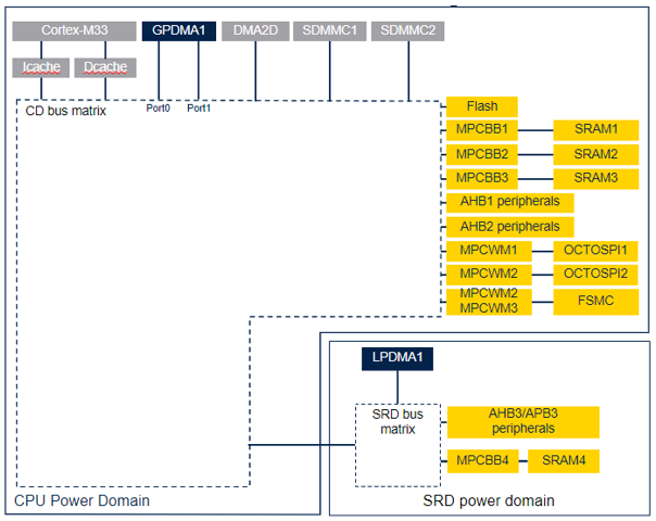

The main application benefit for using DMA in any application is to off-load the CPU for data transfer from a memory mapped source to a memory mapped destination. In the image below, it is possible to see the power domains associated with the GPDMA and LPDMA:
As it can be seen in the above image, the GPDMA comes with 2 Ports. The Port0 should be typically allocated for transfers to/from peripherals as there is a direct hardware data path to APB peripherals, outside the AHB matrix. Port1 on the other hand should be typically allocated for transfers to/from memory. In any case, the GPDMA target can be addressed from any port.
Another interesting factor to take into account is that each channel has a FIFO size and it follows this rule: from channel0 to channel 11 the FIFO is 8bytes (2words) – these channels are ideal for transfers from//to an APB/AHB peripheral to SRAM, for example, UART to a buffer. Channels 12 to 15 have a 32byte (8 words) FIFO, so they are better suited for transfers between a high speed AHB peripheral and SRAM, or for transfer from/to external memories.

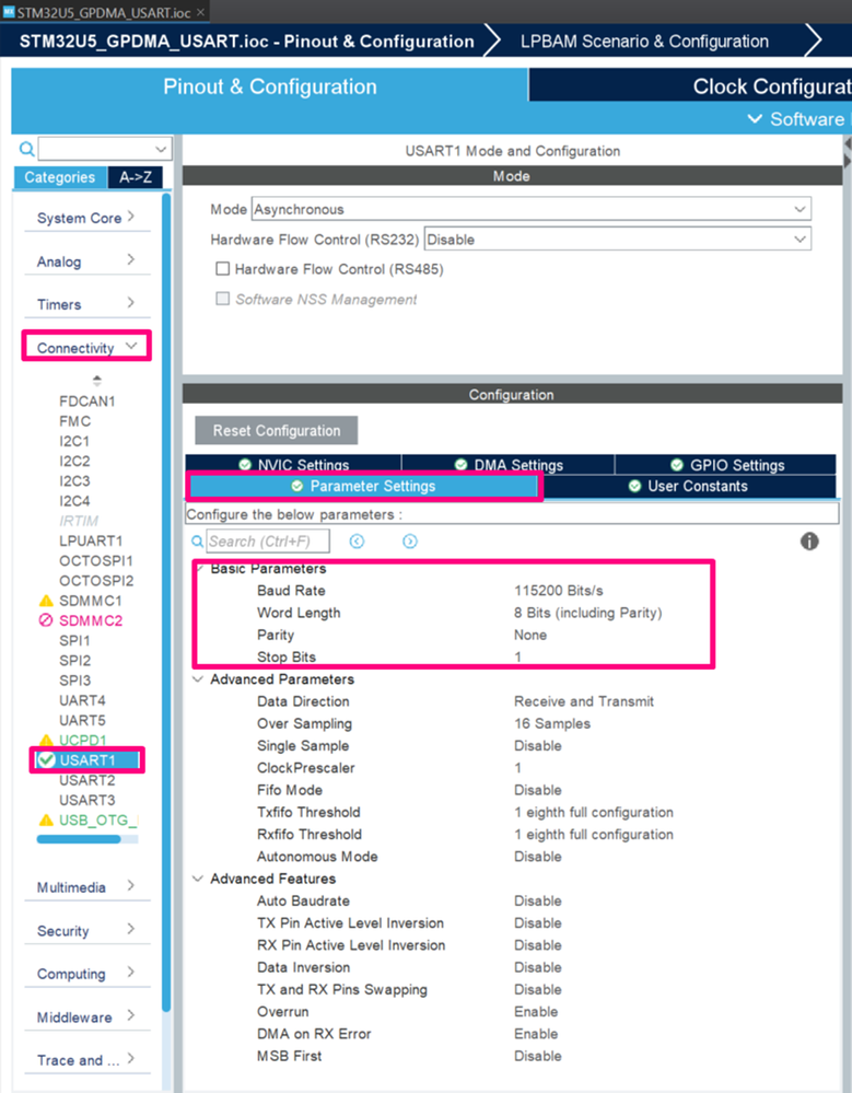

In the *.ioc created, we can locate the “Connectivity” section and expand it to select the USART1, which is connected to the VCOM. Here we’ll use a fairly typical setup for the USART: 115200/8/N/1

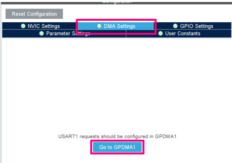

Now, the part we really want to interact with, the GPDMA. If you click in the “DMA Settings” tab, it will show the message to go to GPDMA1:

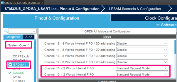

Following the previous guidelines for selecting the GPDMA channels, we’ll assign Channels 10 and 11, both with 2 word FIFO and we’ll set them in Standard Request Mode.

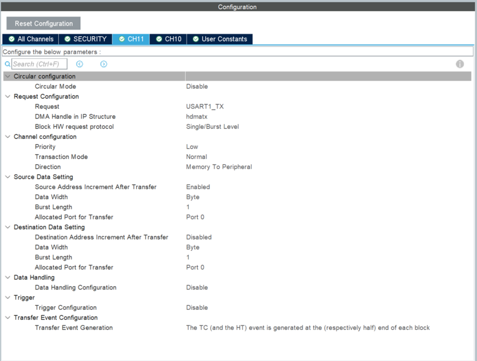

OK, now that the difference is clear, let’s configure the 2 channels: one will be used for USART TX and the other one for USART RX. Just for the sake of showing that both Ports work with the same peripheral, the TX will use Port0 and RX will use Port1.
Here is the configuration for the TX:

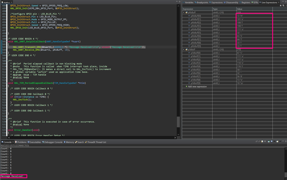

Finally, create the reception complete callback to echo whenever the 10 bytes are received.
/* USER CODE BEGIN 4 */
void HAL_UART_RxCpltCallback(UART_HandleTypeDef *huart)
	HAL_UART_Transmit_DMA(&huart1,(uint8_t *) "Message Received!\r\n", sizeof("Message Received!\r\n"));
	HAL_UART_Receive_DMA(&huart1, pRxBuff, 10);
/* USER CODE END 4 */
6. Code flow demo
Here is a quick demonstration of the code flow, where we can see the message typed ‘Hello ST!!” in the pRxBuff and the local variable being used to change the message in the pTxBuff:
