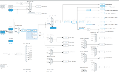

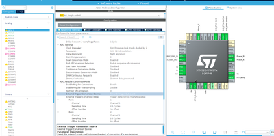

Hello everybody,
I am trying to synchronize the ADC1 and ADC2 to work with center-aligned PWM signals in dual-simultaneous regular mode using DMA. My setup:
PWM frequency: 5.2 kHZ
ADC conversion frequency: 104/2 = 52 MHZ
If I have 3 conversions per ADC with every single one lasting 2.5 cycles, according to the reference manual:
One conversion : (2.5 + 12.5)*19ns = 285 ns
Three conversions: 285*3 = 855 ns

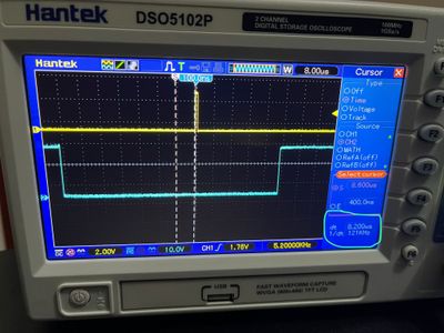

The problem is when I hook up oscilloscope I see that I am getting 8.2us until I reach my interrupt routine which is much longer than expected. I want to do all of my conversions at the moment when CNT=ARR so that I make sure lower side of the FET is ON. I am doing this by setting another channel of the timer to use it only for the time base and setting its TIMx.Pulse = ARR -1.

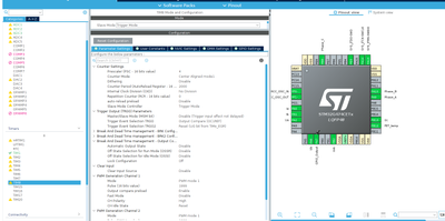

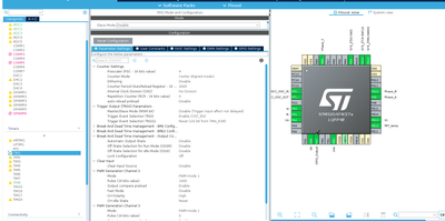

Also TIM1 and TIM8 are synchronized through master/slave in trigger mode on enabling the counter.
Picture of the scope:
Yellow : PA7 - GPIO
Blue: TIM1CH2 PWM

/** Common config
hadc1.Instance = ADC1;
hadc1.Init.ClockPrescaler = ADC_CLOCK_SYNC_PCLK_DIV2;
hadc1.Init.Resolution = ADC_RESOLUTION_12B;
hadc1.Init.DataAlign = ADC_DATAALIGN_RIGHT;
hadc1.Init.GainCompensation = 0;
hadc1.Init.ScanConvMode = ADC_SCAN_ENABLE;
hadc1.Init.EOCSelection = ADC_EOC_SEQ_CONV;
hadc1.Init.LowPowerAutoWait = DISABLE;
hadc1.Init.ContinuousConvMode = DISABLE;
hadc1.Init.NbrOfConversion = 3;
hadc1.Init.DiscontinuousConvMode = DISABLE;
hadc1.Init.ExternalTrigConv = ADC_EXTERNALTRIG_T8_TRGO;
hadc1.Init.ExternalTrigConvEdge = ADC_EXTERNALTRIGCONVEDGE_FALLING;
hadc1.Init.DMAContinuousRequests = ENABLE;
hadc1.Init.Overrun = ADC_OVR_DATA_PRESERVED;
hadc1.Init.OversamplingMode = DISABLE;
if (HAL_ADC_Init(&hadc1) != HAL_OK)
Error_Handler();
/** Configure the ADC multi-mode
multimode.Mode = ADC_DUALMODE_REGSIMULT;
multimode.DMAAccessMode = ADC_DMAACCESSMODE_12_10_BITS;
multimode.TwoSamplingDelay = ADC_TWOSAMPLINGDELAY_1CYCLE;
if (HAL_ADCEx_MultiModeConfigChannel(&hadc1, &multimode) != HAL_OK)
Error_Handler();
/** Configure Regular Channel
sConfig.Channel = ADC_CHANNEL_3;
sConfig.Rank = ADC_REGULAR_RANK_1;
sConfig.SamplingTime = ADC_SAMPLETIME_2CYCLES_5;
sConfig.SingleDiff = ADC_SINGLE_ENDED;
sConfig.OffsetNumber = ADC_OFFSET_NONE;
sConfig.Offset = 0;
if (HAL_ADC_ConfigChannel(&hadc1, &sConfig) != HAL_OK)
Error_Handler();
sConfig.Channel = ADC_CHANNEL_1;
sConfig.Rank = ADC_REGULAR_RANK_2;
Error_Handler();
sConfig.Channel = ADC_CHANNEL_11;
sConfig.Rank = ADC_REGULAR_RANK_3;
Error_Handler();
/* USER CODE BEGIN ADC1_Init 2 */

* @brief TIM1 Initialization Function
* @param None
* @retval None
static void MX_TIM1_Init(void)
/* USER CODE BEGIN TIM1_Init 0 */
/* USER CODE END TIM1_Init 0 */
TIM_MasterConfigTypeDef sMasterConfig = {0};
TIM_OC_InitTypeDef sConfigOC = {0};
TIM_BreakDeadTimeConfigTypeDef sBreakDeadTimeConfig = {0};
/* USER CODE BEGIN TIM1_Init 1 */
/* USER CODE END TIM1_Init 1 */
htim1.Instance = TIM1;
htim1.Init.Prescaler = 4;
htim1.Init.CounterMode = TIM_COUNTERMODE_CENTERALIGNED1;
htim1.Init.Period = 2000;
htim1.Init.ClockDivision = TIM_CLOCKDIVISION_DIV1;
htim1.Init.RepetitionCounter = 0;
htim1.Init.AutoReloadPreload = TIM_AUTORELOAD_PRELOAD_DISABLE;
if (HAL_TIM_PWM_Init(&htim1) != HAL_OK)
Error_Handler();
sMasterConfig.MasterOutputTrigger = TIM_TRGO_ENABLE;
sMasterConfig.MasterOutputTrigger2 = TIM_TRGO2_RESET;
sMasterConfig.MasterSlaveMode = TIM_MASTERSLAVEMODE_DISABLE;
if (HAL_TIMEx_MasterConfigSynchronization(&htim1, &sMasterConfig) != HAL_OK)
Error_Handler();
sConfigOC.OCMode = TIM_OCMODE_PWM1;
sConfigOC.Pulse = 1000;
sConfigOC.OCPolarity = TIM_OCPOLARITY_HIGH;
sConfigOC.OCNPolarity = TIM_OCNPOLARITY_HIGH;
sConfigOC.OCFastMode = TIM_OCFAST_DISABLE;
sConfigOC.OCIdleState = TIM_OCIDLESTATE_RESET;
sConfigOC.OCNIdleState = TIM_OCNIDLESTATE_RESET;
if (HAL_TIM_PWM_ConfigChannel(&htim1, &sConfigOC, TIM_CHANNEL_2) != HAL_OK)
Error_Handler();
sConfigOC.Pulse = 0;
if (HAL_TIM_PWM_ConfigChannel(&htim1, &sConfigOC, TIM_CHANNEL_3) != HAL_OK)
Error_Handler();
sBreakDeadTimeConfig.OffStateRunMode = TIM_OSSR_DISABLE;
sBreakDeadTimeConfig.OffStateIDLEMode = TIM_OSSI_DISABLE;
sBreakDeadTimeConfig.LockLevel = TIM_LOCKLEVEL_OFF;
sBreakDeadTimeConfig.DeadTime = 0;
sBreakDeadTimeConfig.BreakState = TIM_BREAK_DISABLE;
sBreakDeadTimeConfig.BreakPolarity = TIM_BREAKPOLARITY_HIGH;

Toggling a pin within an interrupt is not an accurate way to time how long it takes to do an ADC conversion. You are introducing overhead due to the context switch. This is also subject to bus delays. Writing to a GPIO pin is not immediate.
If you want to time the ADC to verify the timings it says in the reference manual, do 1000 conversions using DMA to a buffer. Then do 10000. Take the difference in timings and that's how long it takes for 9000 conversions. This eliminates the errors due to overhead and context switch. It will still have a few counts of jitter.
richi
Hey TDK, I am not concerned about the duration of an interrupt as it may seem , rather I am concerned about the time before programm jumps into the interrupt routine. I am expecting it to be around ~1us as per mentioned calculation in original post. I am not sure why it takes so much time to get to the interrupt routine. In the interrupt routine I am just reading the results from the buffer, it has nothing to do with the conversion itself.
The fault in the measurement is the same--overhead from the CPU running code. The interrupt doesn't start immediately after the conversions are complete.
More to the point you're interested in: If you want to see the exact moment sampling starts, attach one channel of the scope to the ADC pin. You will see a small drop or spike in the signal when the sampling capacitor is connected.
richi
I still don't understand what is the cause of this delay and what should I do to minimize it as much as possible.
Write your own code and don't rely on HAL if you want the fastest possible code execution.
