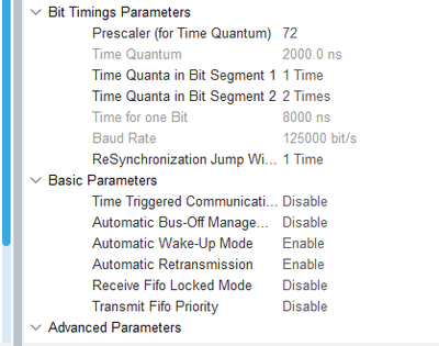

I am Struggling with STM32L432 CAN Bus communication from one STM32L432 to another STM32L432 using MCP2551.
* I have checked loopback works.

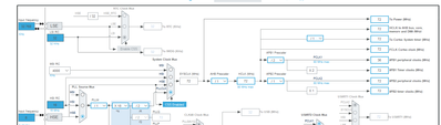

*I am using HSE Clock (After soldering SB17) -
* I have also tried putting Oscilloscope at TX pins between STM32 Transmitter and MCP2551 but signal just stays high.

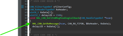

* Plus, i can see that this never triggers but putting it in debug mode and putting a breakpoint in there
I also tried following this guy: 115. STM32CubeIDE MCP2551 CAN BUS with STM32 F103C8T6
but to no avail.
* I also tried doing the same setup i.e. ADC on transmitter sending information to other side via CANBUS.
* I have quadrupled checked Hardware circuitry, and all seems to be right.
* CANBUS Distance is also less than a meter now with termination at both ends.

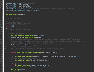

TX Code -

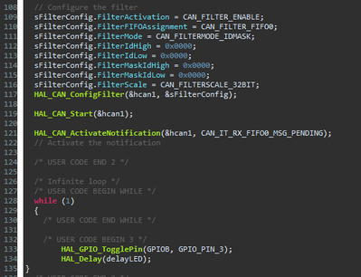

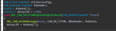

RX Code -

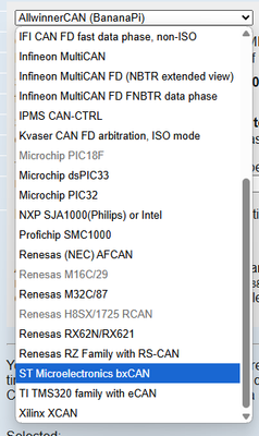

Second, these are a very bad bit timing parameters:
You need to decrease as much as possible the Prescaler and increase as much as possible BS1 and BS2 while having a simple point at around 87%;
Refer to this article: CAN (bxCAN) bit time configuration on STM32 MCUs
This link can help you to calculate the timings parameters. You need to select:
Hope that helps.

You should try playing with the parameters , increase the sample points , use internal/ external loop back mode and see if the RxCallback Triggers, you can refer to https://kvaser.com/support/calculators/bit-timing-calculator/ this website for the CAN bus timing parameters , works well with the ST Boards and is easy to use, You will most likely get the Communication started.
YOU ARE A LEGEND!!!
Thank you.... i was stuck on this for so long.
Thank you for commenting, Much appreciated.
Problem is resolved by mƎALLEm.
