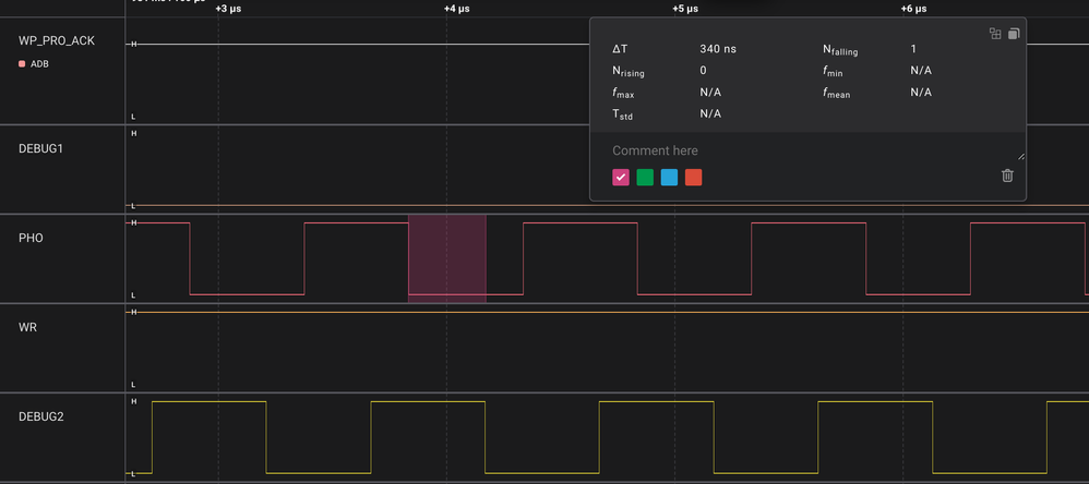

The GPIO B12 is used to check the latency between each Phi0 phase,
- at the falling edge of Phi0 B13 is clear
- at the rising edge of Phi0 B13 is set,
I have nothing else running on this STM32, I am observing a delay (avg 335 ns) between the interrupt detection and GPIO set or clear.
Using the logic analyzer:
Debug2 is the GPIO B13

335ns at 100 MHz is 33 ticks. That's about as good as you're going to get with this approach. Might be able to get it down to low 20s.
1) There's a 12-cycle delay for the ISR to fire on the M4 core.
1a) I suspect there are a few clocks of delay between the actual edge and the interrupt becoming pending.
2) There are additional flash wait states if the ISR instruction is not in memory.
3) You have a few instructions before actually setting the GPIO value. These use the same bus to communicate as setting the GPIO. Look at disassembly to see what it's doing.
4) The write to GPIO is not instant and will take a few cycles as well.
You can eliminate (2) by putting instructions in RAM. And you can affect (3), but only slightly.

I can see using the PC that it is executing from RAM, However it is not reducing the GAP I still have between 340 & 400 ns delay. This is not normal,
What is wrong with this STM32 ?
Vincent
Why do you think it is not normal?
What results are you expecting instead?
Did you look at the disassembly? Cortex M4 has (minimum) cycle counts for each instruction. Add them up and compare that to what you're seeing.
I will check the dissassembly,
It is more like 500 ns  means 50 cycle (OK 12 for the ISR), but stil 38 cycle to trigger a GPIO
seems strange !
