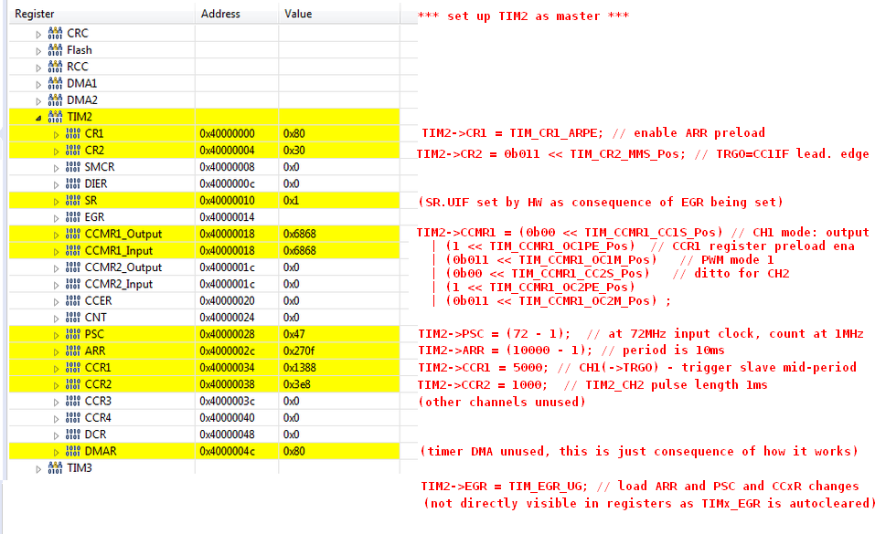

Hello:
Using the Nucleo STM32L476RG demo board.
On an STM32F4xx, using CMSIS, I am able to create 2 PWM pulses that have the same period. However, the 2nd pulse is delayed by: TIM4->CNT = TIM3->CNT + (timerPeriod /2 ); // =180 degrees
I want to do the same thing using HAL, but it looks like a few things have changed from CMSIS!
I have my code where I have 2 pulses being generated at the correct duty cycle and frequency, but spinning the wheels on how to get the second pulse delayed as shown above.
Can someone please provide some insight on how I could accomplish this? Has HAL made it easier than CMSIS? Or just different?
Thanks!

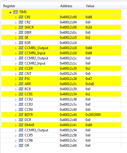

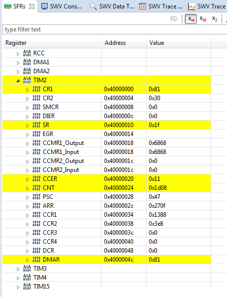

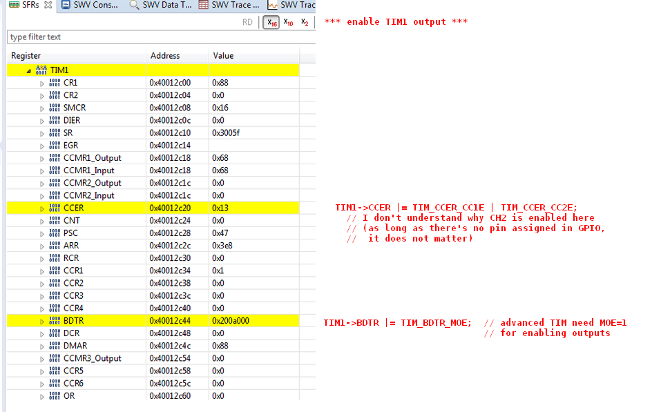

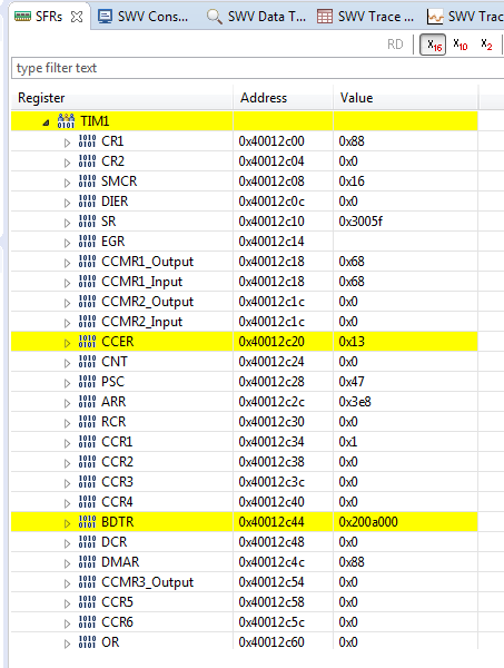

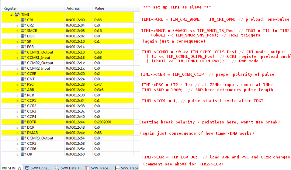

Posted on February 20, 2018 at 19:05
I hope this is what you wanted!

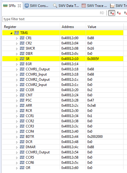

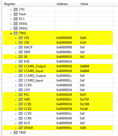

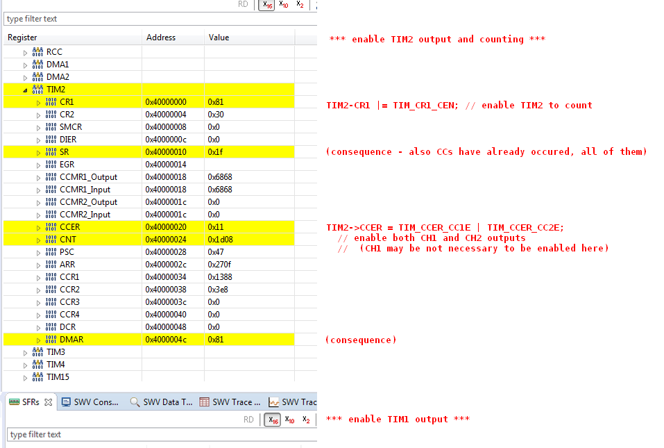

After Master (TIM2) INIT;
After Slave (TIM1) INIT;
After Master (TIM2) PWM Starts;
Slave (TIM1) after Master PWM Starts only:
finally after SLAVE (TIM1) PWM Startup
Posted on February 21, 2018 at 05:46
hereCubeMX ioc file
NoteI tested this on Nucleo-F303RE.
I don't have a 476, but i threw a cubemx file together for you.

Posted on February 25, 2018 at 16:06
John,
thanks for the details.
I ''decomposed'' it into register accesses, and then modified it for a simple demo program (in attachment).
It may seem that there's quite a lot of typing; but in fact, once you already set up a timer in this manner, it's mostly copy/paste/modify, and the possibility to add comments as appropriate is IMO a bonus.
