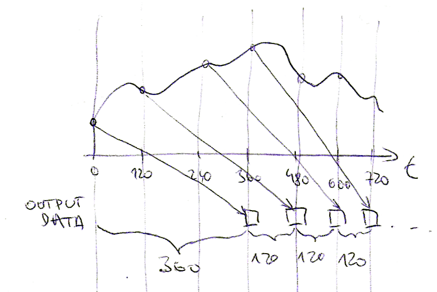

waclawek.jan
Posted on February 28, 2018 at 10:34
This is not a plain SAR ADC, and the digital filters inherent to sigma-delta conversion involve delays. The 120 cycles per conversion is the maximum sampling rate, but the samples are pipelined (i.e. they pass through several filtering stages) making up the 360 cycles total delay/'latency'. As the RM puts it in Continuous and fast continuous modes subchapter:
In fast continuous mode (FAST=1), the first conversion takes still 360 SDADC clocks, but then each subsequent conversion finishes in 120 SDADC clocks.

roger
Posted on February 28, 2018 at 16:01
Hmm ?
I have my SDADC in fast continuous mode.
It's simply takes 360 cycles until the signal propagates from analog input to the output data buffer, i.e. 60us,  that's all.
But this is only the first conversion takes ! Each subsequent conversion finishes in 120 SDADC clocks i.e 20us !

Posted on February 28, 2018 at 15:24
No. It's simply takes 360 cycles until the signal propagates from analog input to the output data buffer, i.e. 60us,  that's all.

roger
Posted on March 01, 2018 at 09:35
Hi JW
Thank you very much. Now i understand.
Conversion time is each subsequent conversion and = 20us
But Attention! The first conversion need 360 cycles at the phase time minimum result = 60us
Conclusion:
For the Phase time (Latency) only the filter is responsible.
Thanks
