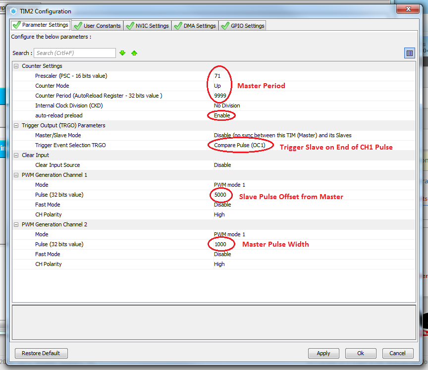

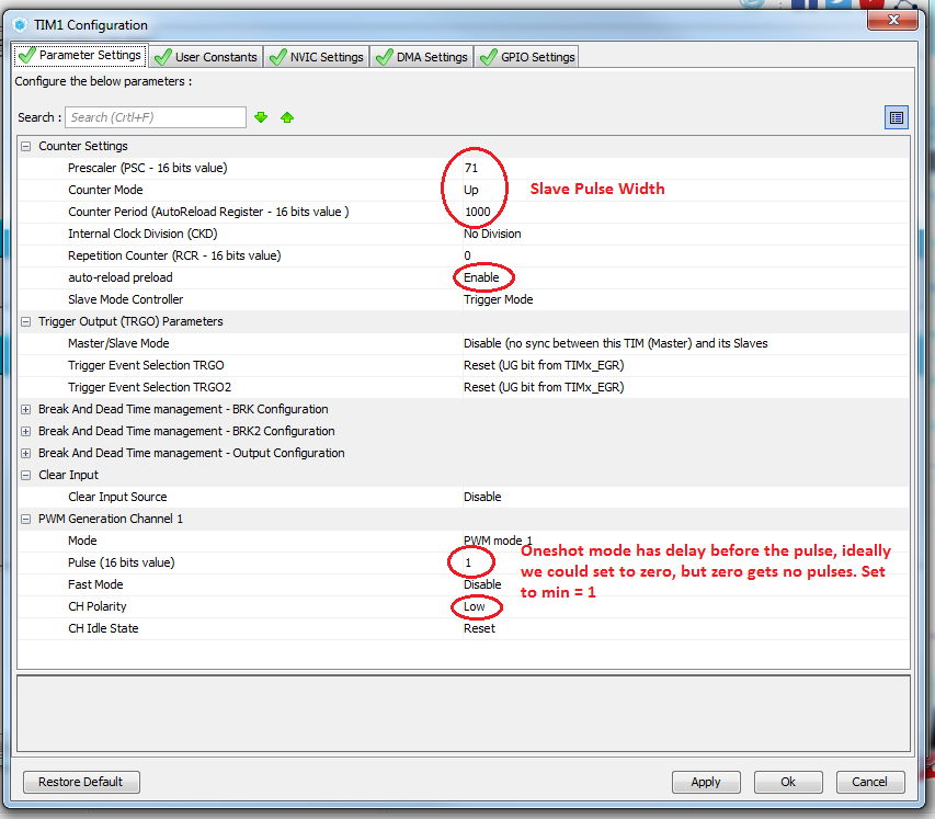

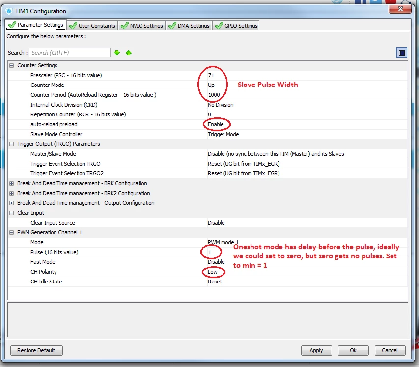

    The alternative, which is probably a little cleaner,(no math and single calls for each parameter change):
    add PWM on CH2 to master timer, using this as master output pulse.
    use PWM on CH1 on master as the phase shift.
    change master TRGO to the Compare Pulse (OC1) event
    Set Slave CH1 pulse width to 1 (delay before the pulse, must be > zero)
    then start things with;
    HAL_TIM_PWM_Start(&htim2, TIM_CHANNEL_1); HAL_TIM_PWM_Start(&htim2, TIM_CHANNEL_2); HAL_TIM_OnePulse_Start(&htim1, TIM_CHANNEL_1);
    use these to make changes to timing;
    __HAL_TIM_SET_AUTORELOAD(&htim2, period); //set master period __HAL_TIM_SET_COMPARE(&htim2, TIM_CHANNEL_2, tm); //set master pulse width __HAL_TIM_SET_COMPARE(&htim2, TIM_CHANNEL_1, (offset-1)); //set slave pulse offset __HAL_TIM_SET_AUTORELOAD(&htim1, ts); //set slave pulse width    // change period with 180deg phase
    __HAL_TIM_SET_AUTORELOAD(&htim2, newperiod); //set master period __HAL_TIM_SET_COMPARE(&htim2, TIM_CHANNEL_1, (
    newperiod/2
    John Craven
    Senior
    February 20, 2018
    Posted on February 20, 2018 at 17:59

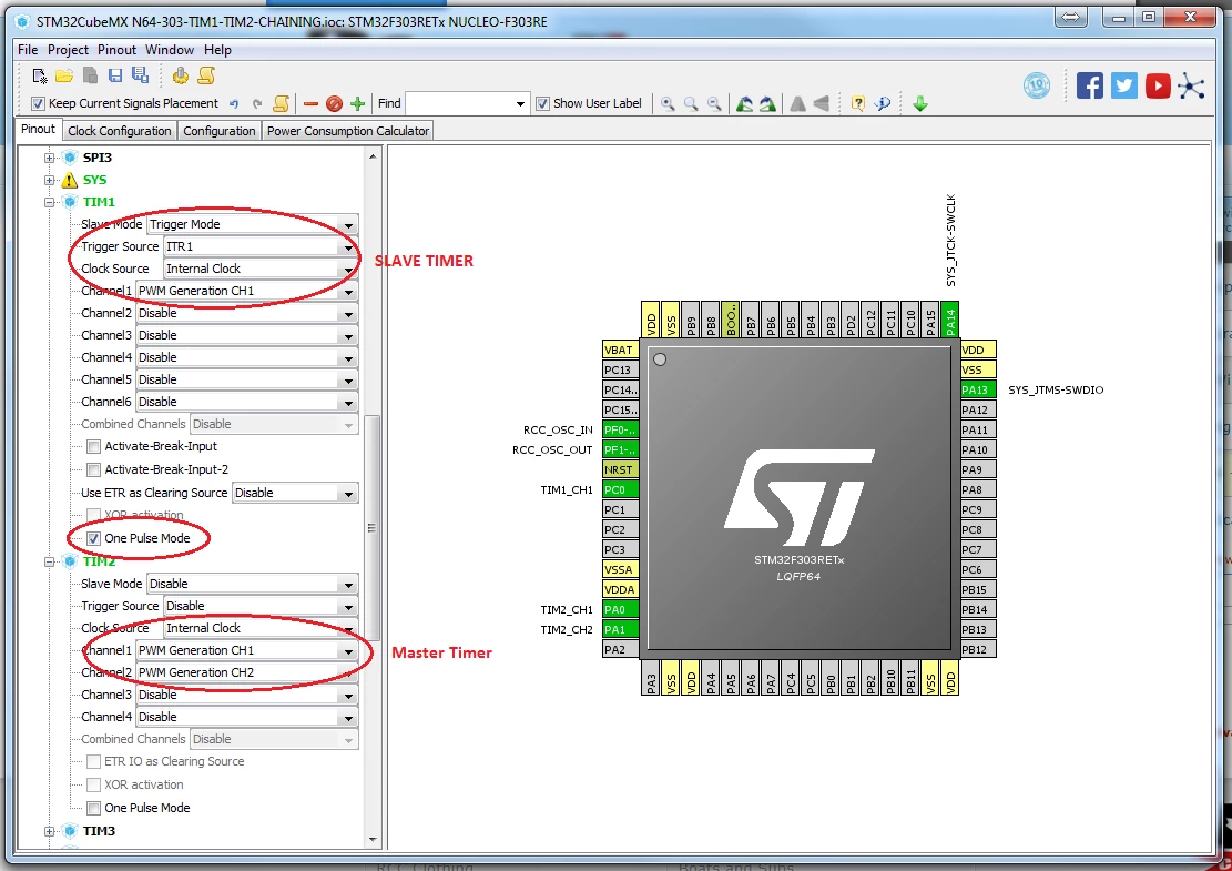

     For CubeMX users, this is the setup for the clean code alternative i posted.

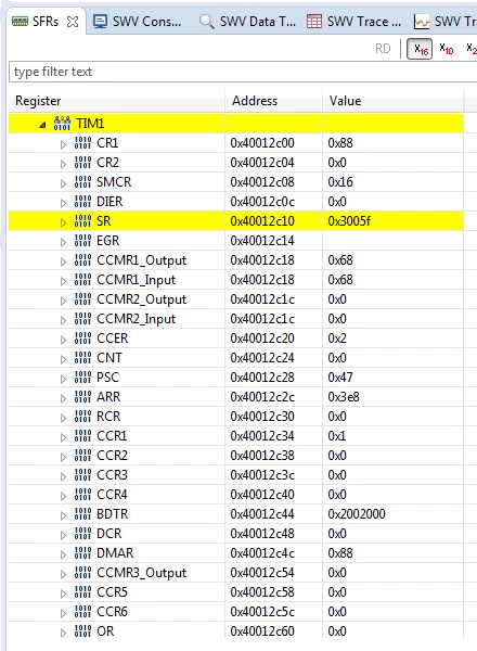

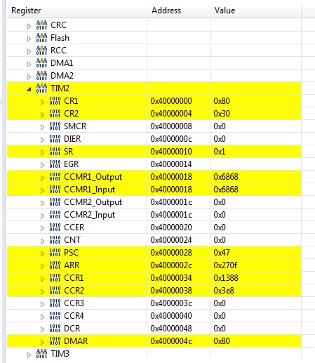

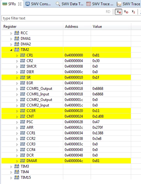

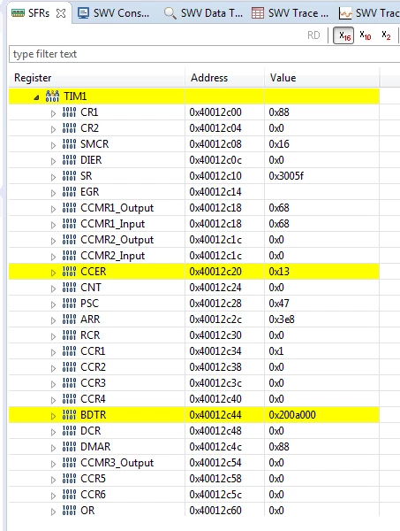

    John,
    Could you please express it also in terms of TIM registers content? It's enough to read them out in debugger.
    Thanks,

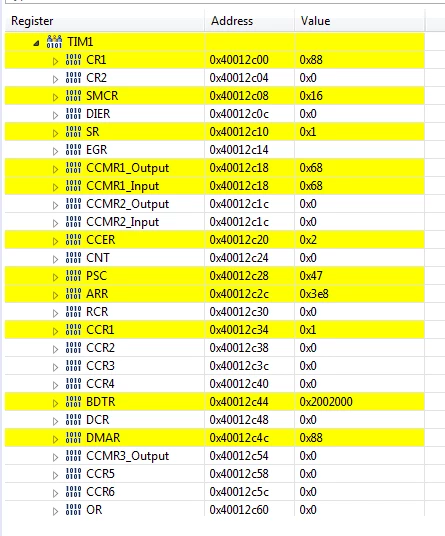

    John Craven
    Senior
    February 20, 2018
    Posted on February 20, 2018 at 19:05
    I hope this is what you wanted!
    After Master (TIM2) INIT;
    After Slave (TIM1) INIT;
    After Master (TIM2) PWM Starts;
    Slave (TIM1) after Master PWM Starts only:
    finally after SLAVE (TIM1) PWM Startup

    hereCubeMX ioc file
    NoteI tested this on Nucleo-F303RE.
    I don't have a 476, but i threw a cubemx file together for you.
