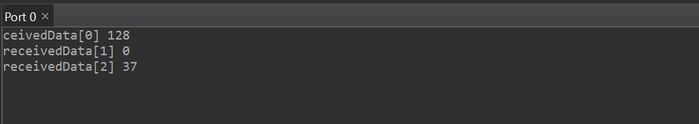

 Using HAL_SPI_TransmitReceive properly. I've corrected the code to send the command 0x25 followed by two dummy bytes (0x00, 0x00) in a single transaction to read the ACC register.
However, now I’m facing a new issue: no matter what value I set for ACC, when I read it back, I always get 0x80 0x00 0x89 (i.e., 128 0 137). I double-checked the write sequence as well and it appears to complete successfully.(I am able to execute run command)
I’ve also attached the image and my updated code for reference. Any suggestions on what I might be missing?
Additionally, I’ve already set all KVALs and MAX_SPEED to their maximum values, yet the motor won't go beyond ~1000 steps/sec. Beyond that, it starts vibrating heavily and doesn’t rotate at all, I am using NEMA 17 and NEMA 23 with 24v Supply and tried with no load condition and with some load as well. Phase resistance for NEMA 17 is 3.3R  and Inductance 2.8 mH/phase and fot NEMA 23 has 2.23R and Inductance: 2.25 mH plus it is heating even just pasing 1A to 55 C.
I've attached an image and included my updated code for reference. Any suggestions on what I might be missing would be greatly appreciated.
Thanks again for your help and patience!

uint32_t L6470_ReadABS_POS(void) {
    static uint8_t receivedData[3] = {0x00,0x00, 0x00};
	uint8_t tx_buf[3] = {0x25, 0x00, 0x00};  // 0x25 = GET_PARAM | ACC (0x05), followed by 2 dummy bytes
	L6470_CS_Low();
//	  HAL_Delay(10);
	  HAL_SPI_TransmitReceive(&hspi2,tx_buf,receivedData,3,HAL_MAX_DELAY);
	  L6470_CS_High();
	  //HAL_Delay(10);
    printf("receivedData[0] %d \r\n",receivedData[0]);
    printf("receivedData[1] %d \r\n",receivedData[1]);
    printf("receivedData[2] %d \r\n",receivedData[2]);

Hello @Dev29 ,
have you verified that the CPHA/CPOL configuration is consistent with that required by the device?
Is the device in HiZ status? Otherwise the writing of some registers is rejected.
Regarding the rotation problem: I suggest you read the application notes dedicated to Voltage mode:
AN4144 - Voltage mode control operation and parameter optimization
You can find a detailed description on how to optimize the parameters.
