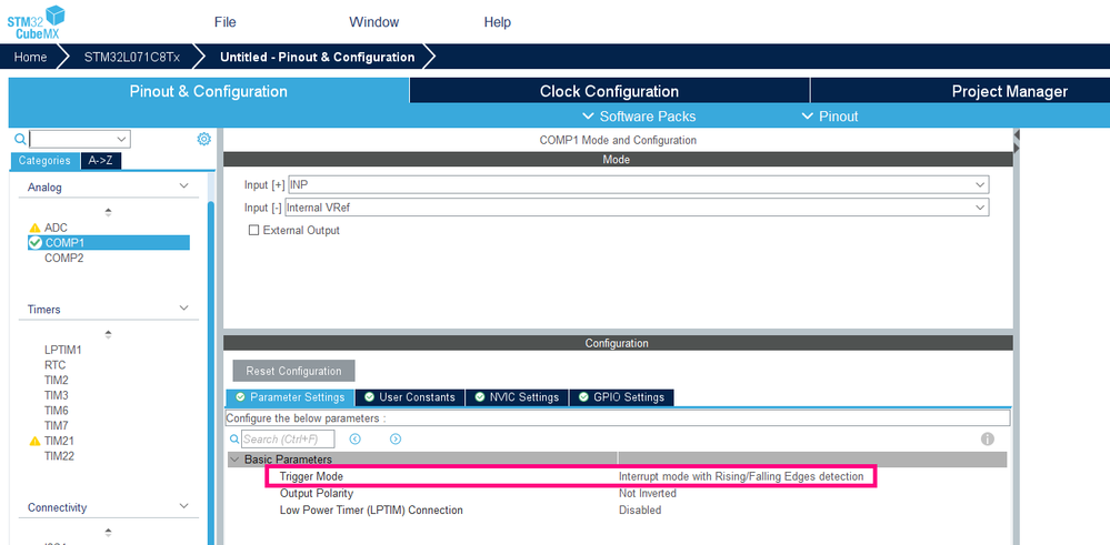

I am using the STM32L071 with the latest STM32 studio software. I cannot find any sign of the VREFBUF configuration in the libraries (I need to enable the internal voltage reference for the COMP1 peripheral). I have found this article for H7 device:

Thank you for the answer @KDJEM.1​ ,
Currently I am unable to force the COMP1 interrupt, so I assumed the internal VREF is not turned on- could you help me turning it on in case that is the issue? I have set it as the COMP "-" input source.
KDJEM.1
Hello @Community member​ ,
If you use the STM32CubeMX, make sure that select the interrupt mode with Rising/Falling edges detection in Trigger mode as shown in the below figure.
Also, I advise you to get inspired from the available COMP_Interrupt example in the STM32CubeL0 MCU package.
This example may help you in the configuration by following the instructions in the readme file.
Kaouthar

Thanks @KDJEM.1​ , what I was missing is:
  /*##-2- Configure the Vref #################################################*/
  /* Enable the Vrefint */
  HAL_COMPEx_EnableVREFINT();
  /*##-3- Start teh COMP1 and enable the interrupt ###########################*/
  if(HAL_COMP_Start(&hcomp1) != HAL_OK)
    /* Initiliazation Error */
    Error_Handler();
Now it works.
