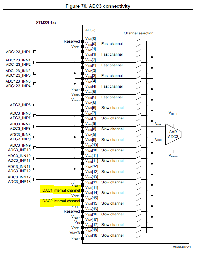

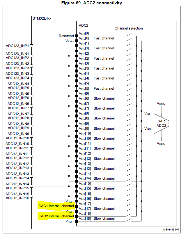

I'm planning to use a STM32L476 to acquire approx 150 analog signals.
For some reasons, I have to periodically check the justness of the ADCs.
I read in the RM that it is possible to connect internally DAC to ADC but I can not figure out how to select on which ADC & ADC channel the DAC output is "routed" to.
Can someone point me to info related to this ?

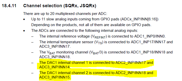

In fact the answer is in the RM (0351), section 18.4.11 "Channel selection (SQRx, JSQRx")
0693W00000Sv0GPQAZ.pngIt is mentioned that :
  • The DAC1 internal channel 1 is connected to ADC2_INP/INN17 and ADC3_INP/INN14
  • The DAC1 internal channel 2 is connected to ADC2_INP/INN18 and ADC3_INP/INN15
As indicated on the schemas that you can also find in the RM
0693W00000Sv0IkQAJ.png0693W00000Sv0J4QAJ.pngPlease find in attached the document ;) .

According STM32L47xx RM0351 Rev 9, chapter 18 ADC, page 509 and 510.
Non Bufferized DAC1 and DAC2 channels are internally connected in single-ended to
  • ADC2 IN17 and IN18.
  • ADC3 IN14 and IN15.
Here the link:
