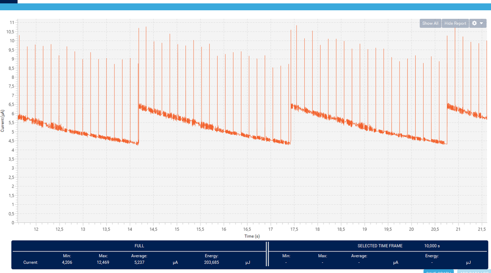

Hey all,
I’m trying to squeeze the lowest possible STOP1 current out of an STM32U031F8P6 (TSSOP-20), no external crystals. The board itself looks fine: in the deepest mode (Shutdown/Standby) I see < 0.5 µA, so I don’t think it’s a hardware leak.
Goal (later): run ADC at 1 kHz triggered by LPTIM1 from LSI, push to DMA (circular), and only wake after 1000 samples (DMA TC). While that runs, the core should sit in STOP1 (low-power regulator).
Problem (now, with everything stripped):
Even with a minimal firmware that goes straight to STOP1 and (supposedly) nothing enabled, I measure ~5–6 µA average at room temp. The current trace shows a baseline of ~4.2–5 µA with short spikes to ~10–12 µA every ~100 ms. That really looks like something waking up periodically.
What I see on the analyzer (≈3 V supply):
  • Baseline settles around 4.2–5 µA
  • Spikes to ~10–12 µA every ~100 ms
  • Average ≈ 5.2 µA
If I switch to the deepest mode, I get < 0.5 µA, which makes me think the PCB is fine and I’m just missing a setting in STOP1.

  1. On STM32U031, is there anything “hidden” that could explain a ~100 ms periodic blip in STOP1 (some default monitor/oscillator/retention I’m not switching off)?
  2. Any extra register bits specific to U0 that I should clear for a truly quiet STOP1 beyond the usual suspects above?
  3. Could EXTI/WKUP pins be doing this even if I didn’t configure them? Any default WKUP behavior on U031F8P6 I should double-check?
  4. What’s a realistic STOP1 current (everything off: no RTC/LSI, no ADC, Flash PD, no debug, etc.) that I should expect on this device so I can sanity-check my ~4–5 µA baseline (between spikes)?

current graph showing spikescurrent graph showing spikes
1 REPLY 1
Sarra.S
Hello @leddel32;,
Check for any enabled EXTI lines configured in interrupt or event mode, they may lead to unintended wake-ups or current spikes in STOP1 mode
