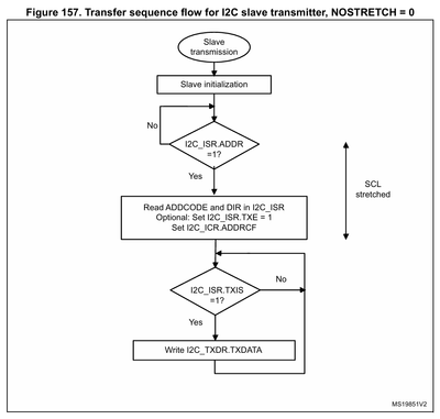

Hello! This is the first time I'm using an STM32L0 (...11F4Ux) and also the first time I've tried implementing an I2C IRQ Handler. The code snippet mostly works, but there's a bug in which a READ commands sends data from the previously requested register, giving bad data. Basically, the data I receive is old by 1 request, which tells me this IRQ Handler is not handling the repeated start correctly. The exception to this is that the very first READ command is correct when I start up I2C tools on a RP5. I've been trying to figure out this bug for a couple of days now, so I'd really appreciate any help from more experience developers, thank you!
Details:
  • Flash limited to 16KB, so using LL drivers only
  • This snippet is broken out into its own file and is called by I2C1_IRQHandler();
  • WRITE commands work perfectly fine
  • When placing a stop at the LL_I2C_TransmitData8(I2C1, tx_val);, I get data from my previous command without this line executing.
  • Master: Raspberry Pi 5 Compute module using I2Ctools. (i.e. i2cget -y 1 0x21 0x02 - read ADC BATT)
I'm 99% certain the bug exist in the handler itself but I can't seem to narrow it down. Somehow data is being stored between READ commands.

Only process the TXIS flag and write data after you have received ADDR. Until then, ignore TXIS flag. You'll need a software state machine to understand where in the transaction you're at.
3 REPLIES 3
mhamilton512
Okay thanks, I understand the idea, but I'm not sure how to ignore the TXIS flag. Based on my code I expect LL_I2C_IsActiveFlag_TXIS to execute only on the repeated start, and never before ADDR is received. In debug mode, if I set a breakpoint at LL_I2C_TransmitData8(I2C1, tx_val) in my TXIS block, I still get data without this line executing which is very confusing to me. How is that possible?
The reference manual explains how the flag functions and when it gets set. I understand you don't want TXIS to be set, but that's now how the chip works. You will need to adjust your code to match. The reference manual explains this.
In blocking mode, data will not be sent without TXIS being asserted and data written to TXDR.
