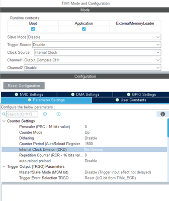

I am testing Tim1 output compare by toggling PA8 on the micro... - the timer settings are
period = 1600, no clock divisor or prescaler and my clock config is below
On the scope I see PA8 toggling with a period of 25us which seems kind a strange...

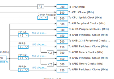

So even if I assume a counter clock of 150Mhz (APB1, APB2 peripheral clocks) and the formula of clock/2*(period+1) as the frequency I should see it toggle at 21.34 us?

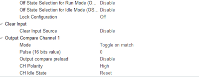

So I have TIM1 configured with a period of 1600 and it is setup to toggle PA8 as the output (via the OUTPUT_COMPARE_CH1) setting - see below
I think you might be right though - maybe it's just latencies - I will try increasing the period and test as you suggested - thanks for all the suggestions
Oh the settings for the output toggle are as below
That is the clock to the timer's APB bus interface.  The timers themselves clock at 2x that rate (i.e. 300 MHz), as shown in the clocking diagram you posted.  I don't know the STM32H7S3V8T6 specifically, but presuming TIM1 is on the APB1/2 bus like other STM32 families.
That doesn't fix your measured vs calculated discrepancy, but makes the calculated period 10.67us.
JShro
@Bob S Thanks for the clarification - Yes I was a bit confused by that considering my measured values I figured maybe the documentation was off and I had to use the bus clock - I do see that the timers appear to be at 300 MHZ input clock - so that's another mystery
You are right if indeed the clock is at 300 Mhz I should be getting 10.67 us which makes this even more strange - Not sure what to make of it - will keep diggging...

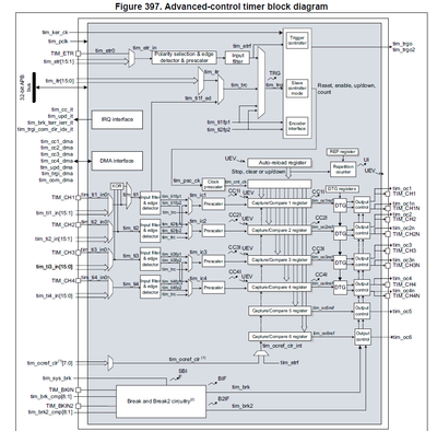

BTW - The tim1 block diagram is pretty confusing for me - it shows the tim_ker_ck and the tim_pck as the clock inputs and then the tim_psc_ck as the final clock to the counter - but not really sure what the source of the tim_psc_ck is I am assuming the 300 MHZ based on your comment but would have been useful to clarify it in the diagram :(
