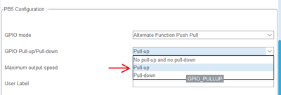

Loopback mode doesn't need an external transceiver. Only normal mode does.
Try to configure the Pull-up/Pull-down of the CAN_Rx pin (PB5 in you case) as Pull-up.
‎2024-01-09 2:54 AM
Thank you for your reply.
However after doing the required changes, I am still facing the same issue.
I would like to know what exactly does changing the GPIO to Pull-Up mode will do.

‎2024-01-09 7:39 AM
It was a tentative to help you as the pull-up resistor is needed in bxCAN.
Now if it does not solve the issue it should be analyzed deeper..

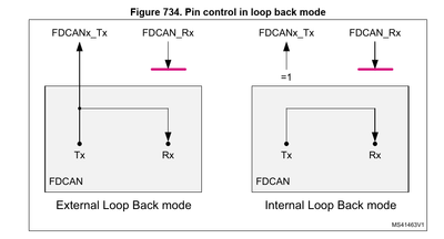

For CAN bus you always need a transceiver, maybe mcp2551.
For a first test, try internal loopback.
If this is working, you can try external loopback, but maybe need set pullup on Tx pin,
or have real transceiver connected, with termination.
