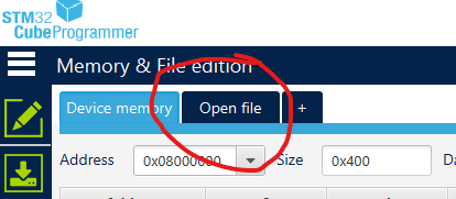

You mention you have used different ST-Link programs, have you also tried STM32CubeProgrammer? If not, you can try updating your ST-Link firmware through STM32CubeProgrammer. If STM32CubeProgrammer does detect your target chip, you can select the flashable binary output of your build folder and flash the chip manually through STM32CubeProgrammer.

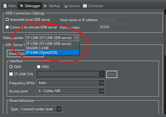

I have had situations where STM32CubeIde did not detect my chip, while STM32CubeProgrammer did. If that's the case, a system restart usually solved the problem for me. You can also try using OpenOCD (Run>Debug Configurations>"Debugger" tab>Debug Probe).

Yes indeed, I am using Nucleo-board. The first thing I certainly did was inspect jumpers ( JP4 set to VDD, JP5 set to VDD 3.3 v, and JP2 set to STLink). Once the device is connected LED5 lights on.
Have a look at Image5 -STM32CubePro, the device is recognised only by its serial number, target voltage, and firmware version but when clicking on CONNECT a msg pops out saying that no STM32 target was found. (of course, one can realise that there is no target info, but why? I frankly have no clue) and I have found it a bit odd that only the serial number is detected.
*U mentioned the selection of the flashable binary output, how can I manage to do it... I couldn't find such a feature anywhere.
** On OpenOCD... image6 can support u with the configuration run.
