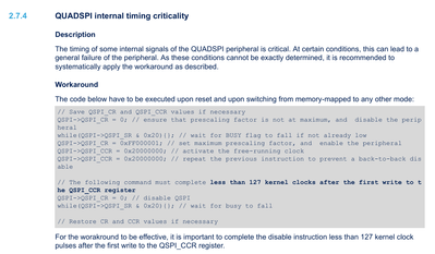

You need to respect QUADSPI internal timing critically as mentioned in the erratasheet.
For that, an additional code must be executed upon reset and upon switching from memory-mapped to any other mode
Thank you.

Some years ago I checked out a QSPI memory mapped demo for a H75x evaluation board but I failed to switch back from memory-mapped to indirect mode. Do you think that the code in the errata may fix that? Or the demo has been improved? If so I'll re-install and check out the demo once again.
