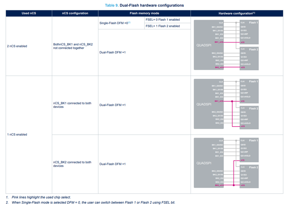

Hi Team,
I am designing a custom PCB using STM32H753 and planning to use the QUADSPI peripheral for external memory. My use case is data read/write (indirect mode) — not XIP or memory-mapped execution.
While working in STM32CubeMX, I came across some configurations that are confusing, and I’d like to clarify the actual hardware behavior.

7. Summary of my understanding (please correct if wrong)
  • QUADSPI has only one internal 4-bit data bus
  • BK1_IOx and BK2_IOx are not independent buses
  • True multi-chip support is limited to 2 devices via NCS/NCS2
  • “Dual bank with single CS” is logical partitioning, not physical dual memory
I would really appreciate clarification from someone who has worked with this peripheral at hardware level or designed boards using it.
Thanks in advance!
JYOTHISH B CHANDRAN
mƎALLEm
Hello @jyothzz and welcome to the ST community,
I think the answer to you question has been answered in the AN4760 "Introduction to Quad-SPI interface for STM32 MCUs and MPUs" / Table 9. Dual-Flash hardware configurations:
1 REPLY 1
mƎALLEm
