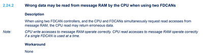

Besides the "slowness" you're facing, and as you are using two CAN instances in your application, there is an errata related to this situation on STM32H750.
Refer to the errata sheet rev 12. Errata 2.24.2

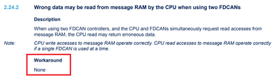

I don't think the errata I mentioned is related to your problem. Just wanted to highlight it as you are using two FDCAN instances and the errata consists of an issue of data integrity not the performance of the communication. And as indicated by the errata, unfortunately, there is no workaround:
