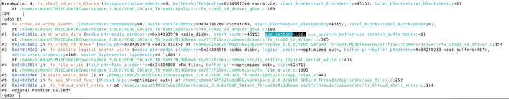

We are using the STM32N6570-DK to encode a video stream (800x600px) and store that at a reasonable data rate to an external sd-card.
I have extended the VENC_SDCARD_ThreadX example to a certain extent to cover the obvious timing differences between the video capture loop and a disk write loop. The sample code is a great way to go forward, but at the moment we reach a data write rate of about 25kb/s when using FileX.
We have initially used the HAL implementation but I have changed the fx_stm32_sd_driver_glue.c code slightly to use the BSP layer for card speed negotiation that is not present in the HAL layer; debug output shows that we're at least using 4-bit wide data transfers>:
CardInfo type 1, version 1, class 1461, spd 0
Inst PWR 00000013 CLKCR 00004004
It seems that just before reaching down to the HAL layer, the single transaction (~200blocks at once, typically), is split  into single sector writes in the sd_write_data function (fx_stm32_sd_driver.c):
Is there a reference implementation showing how this can be set up in the right way?
Being in very early project stages, I can subsitute filex with fatfs or jump to zephyr if this can be done with reasonable effort.
Btw, the current state is here: https://github.com/svogl/venc-sdcard-threadx/tree/feature/filex-bsp-integration

Hi, thanks for coming back to this on short notice. We have been working from the example code on, there is no CubeMX support file, but I think we have enabled the right settings in the code.
If you could have a glimpse at the stack trace, you can see that the application code sends 100-300 sectors in one go (160 in this example) that are passed up through the filex stack as expected.
It is the stm-provided fx_stm32_sd_driver.c file that splits it into single-buffer writes in a loop, which is not what it should be doing. Could you point us to the latest version of that file?

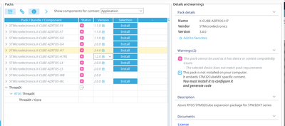

Also, for the N6, I don't see a specific ThreadX support package - which one would be the one to use from:
Thanks a lot
Simon
as the N6xx is M55 core - this should be the package you need.
(Dont see it in your Cube pic...so look on git -> M55)
https://github.com/STMicroelectronics/stm32-mw-threadx
