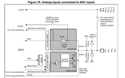

I designed a board that uses a STM32H750 with a USB3300-EZK that has stopped communicating over USB. It's been having intermittent issues for the last day or so (sometimes I'd need to power cycle the board before it would show up, but then it would work flawlessly). Earlier today, I plugged it into a Raspberry Pi, and then it died fully. I've plugged it into that Pi before without issue.
Despite probably hundreds of cycles at this point, I haven't gotten the USB to work again. The PHY is generating a stable 60MHz clock, and DIR is low. I haven't observed any communication on the D0..8 lines. That leads me to believe the problem is with the STM32.
I am using pc2_c and pc3_c, which are supposed to work with USB, although I've heard they're more susceptible to (static?) damage.
I do have a second board that I can switch to, although I don't have a third prototype, and it really would be good to figure out what happened here so I can prevent it from happening again.

Probably you killed a xx_c pin.
It happened to me when using such an pin for SPI to a small display. It was working until I tested it with higher clock rate. Was working some seconds then died away.
This pin never worked again.
So I avoid these xx_c pins for any output signal, just using it as a slow input is okay, or as analog input.
The _c pins are connected through an anlog switch - that can easily be destroyed ....
So maybe you killed it by driving more than 1mA on these pins...

Check: set pin as gpio output (remove connected hardware, that drives this pin) and toggle it, just for test: check with scope, pin working or not.

I'm a little worried I destroyed the _c pins. Although for ULPI they're input pins, right? So there shouldn't really be a risk of overdrive. I don't really have a way to remove the PHY from the circuit without fully taking it off the board, which I would prefer not to do if possible.

If you want to verify Px_C pins still work, you could set them as output and toggle, verify the input follows output. You could also set them as analog and verify ADC returns appropriate values but this may take more rework than is possible.
