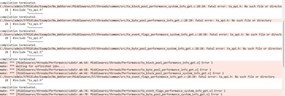

I am trying to build the readily given Nx_webserver project , i had selected the given example and just change the tool chain to STMcube IDE inorder to build the project with the cube ide after redirection to the cube IDE i just click on the build , it ends up with the following error:

C:/Users/admin/STM32Cube/Example/Nx_WebServer/Middlewares/ST/threadx/common/src/tx_block_pool_performance_info_get.c:28:10: fatal error: tx_api.h: No such file or directory
28 | #include "tx_api.h"
compilation terminated.
C:/Users/admin/STM32Cube/Example/Nx_WebServer/Middlewares/ST/threadx/common/src/tx_block_pool_performance_system_info_get.c:28:10: fatal error: tx_api.h: No such file or directory
C:/Users/admin/STM32Cube/Example/Nx_WebServer/Middlewares/ST/threadx/common/src/tx_byte_pool_performance_info_get.c:28:10: fatal error: tx_api.h: No such file or directory
C:/Users/admin/STM32Cube/Example/Nx_WebServer/Middlewares/ST/threadx/common/src/tx_event_flags_performance_system_info_get.c:28:10: fatal error: tx_api.h: No such file or directory
C:/Users/admin/STM32Cube/Example/Nx_WebServer/Middlewares/ST/threadx/common/src/tx_byte_pool_performance_system_info_get.c:28:10: fatal error: tx_api.h: No such file or directory
make: *** [Middlewares/threadx/Performance/subdir.mk:64: Middlewares/threadx/Performance/tx_block_pool_performance_info_get.o] Error 1
make: *** Waiting for unfinished jobs....
make: *** [Middlewares/threadx/Performance/subdir.mk:68: Middlewares/threadx/Performance/tx_byte_pool_performance_info_get.o] Error 1
make: *** [Middlewares/threadx/Performance/subdir.mk:66: Middlewares/threadx/Performance/tx_block_pool_performance_system_info_get.o] Error 1
C:/Users/admin/STM32Cube/Example/Nx_WebServer/Middlewares/ST/threadx/common/src/tx_event_flags_performance_info_get.c:28:10: fatal error: tx_api.h: No such file or directory
make: *** [Middlewares/threadx/Performance/subdir.mk:74: Middlewares/threadx/Performance/tx_event_flags_performance_system_info_get.o] Error 1
make: *** [Middlewares/threadx/Performance/subdir.mk:70: Middlewares/threadx/Performance/tx_byte_pool_performance_system_info_get.o] Error 1
make: *** [Middlewares/threadx/Performance/subdir.mk:72:
Spoiler
Middlewares/threadx/Performance/tx_event_flags_performance_info_get.o] Error 1
C:/Users/admin/STM32Cube/Example/Nx_WebServer/Middlewares/ST/threadx/common/src/tx_mutex_performance_info_get.c:28:10: fatal error: tx_api.h: No such file or directory
C:/Users/admin/STM32Cube/Example/Nx_WebServer/Middlewares/ST/threadx/common/src/tx_mutex_performance_system_info_get.c:28:10: fatal error: tx_api.h: No such file or directory
make: *** [Middlewares/threadx/Performance/subdir.mk:76: Middlewares/threadx/Performance/tx_mutex_performance_info_get.o] Error 1
make: *** [Middlewares/threadx/Performance/subdir.mk:78: Middlewares/threadx/Performance/tx_mutex_performance_system_info_get.o] Error 1
"make -j8 all" terminated with exit code 2. Build might be incomplete.
12:03:22 Build Failed. 17 errors, 0 warnings. (took 2s.319ms)

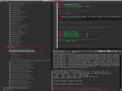

I retested the behavior described using STM32CubeMX 6.16.1, and the compilation finished successfully.

Thank You Now its build for me , there are the path issues , i rectified by manually adding them to builder.
