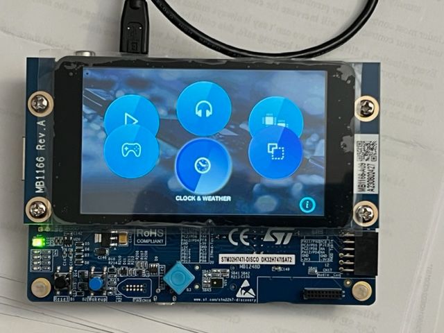

i just received my brand new stm32h747 discovery board, on power-up it does nothing just two LEDs light up, according to the user manual it should be preloaded with a demo.
I checked in cube prog and it reports as blank.
Is it possible that my device got damaged somehow or it is just not flashed?
aren't units tested before shipping out?
Is this a common thing? I don't remember ever receiving a discovery board blank

I just had the same issue, even the reset button was doing nothing.
I connected the board, detected by the Programmer, then I pushed one of the touchGFX samples. and all went fine.
It seems the board came blank!
