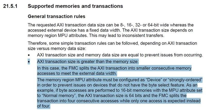

mƎALLEm
From an older reference manual revision:
I think you are in the same case as described above. So try to configure the SDRAM region as Device or Strongly-Ordered using MPU.
I don't know why the case AXI transaction size greater then memory data size with no byte selection has been removed from the specification.
Hope that helps.

RobJ
Thanks,
this seems to fix my problem.
We already had it sel to "strongly ordered" (tex = 0, bufferable = 0, cachable = 0, sharable = 0) but this did not work. Setting it to "device" (bufferable = 1) fixed the issue.
This text is indeed changed in the new reference manual. Maybe this is due to a possible configuration change in future silicon versions of the h747. It works for now but I think we will still fix this to be sure.
As a side note: I completely missed this in the reference manual. The text is exactly where I expect it to be and I even suspected that this was the case. If the reference manual would have used the same "byte enable" text as used in CubeMX instead of "byte select" I would most likely have found this.
