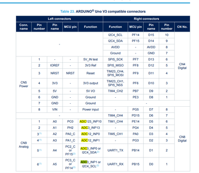

I am doing high-frequency work and I need a screen. STM32H735G-DK is a suitable board for me. However, there is a question that comes to my mind: When I select the board with STMCubeIDE, an exclamation mark appears next to the ADC pins on the board and I perceive the usage as restricted.

Hello @FurkanYilmaz-97 and welcome to the ST Community :smiling_face_with_smiling_eyes:.
In fact, you can use all the Pins on the Arduino CN9 connector as ADC inputs:
For the Red or yellow marks next to an interface, it will show you the pin conflicts (for example here IN2 is not used since PF11 and PF12 are mapped to other functions, if you don't need them, you can just disable those two interfaces (or just remap the pins if possible) and use them for the IN2).
PS: Don't forget that on a board, you can't use all pins on the MCU. You just can use those mapped to external Connectors. Refer to the UM2679 for more details.

Be careful concerning the internal ADC sampling rate, resolution, and resulting signal quality.
Many first time users were disappointed when they found out in real life that the internal ADC did not meet their expectations.
So check the datasheet, wait for some other users' replies here - and tell us what you exactly need.
"High-frequency work" is too inaccurate as a description. ;)

Using the CN9 connector reserved for analog input, I can obtain the analog data I want by determining the processor pin that this pin will map to. Did I understand correctly?
Afterward, I can show the data I have obtained as a graphic on the screen, is it correct?
Exactly, CN9 pins can be configured and use as ADC Inputs.
You can Show the Values on the Screen using some TouchGFX configurations.
Best Regards.
