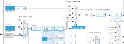

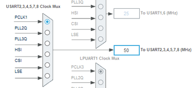

Why the uart stops working on stm32h755 device once the core clock has been modified and code has been generated using cubemx. It comes with a BSP code for serial communication (which i tried seperately) , that is also not working once the core clock has been modified.
by defualt the core clock is in 64Mhz, if i switch the core to HSI with core running at 400Mhz the uart is giving garabage on the terminal in a fresh project.
This is the initilization function generated by cubemx

The reason I am posting this here is that I have access to a couple of other STM32 devices where I have done the same but haven't faced such an issue.
I am currently using the 1.11.2 STM32H7 package.
Best answer by mƎALLEm
I didn't reproduce the issue @400Mhz (attached the modified ioc file). "Welcome to STM32 world !" is well displayed.
Are you using the latest version of CubeMx 6.12.0 ?
Check also your cable.
