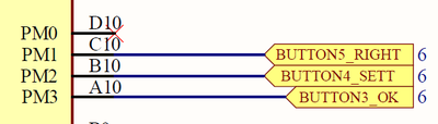

We have implemented a total of five push buttons—two connected to Port E and three connected to Port M.
The GPIOs of Port E are functioning correctly. However, the GPIOs of the push buttons on Port M are not being detected properly by the MCU.
Even when the switches are unpressed, the MCU is detecting a Pressed condition.
PORT M GPIO Pin out: PM1, PM2, PM3.
MCU part: #STM32H7R7L8H6H

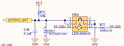

I have checked  push button from hardware side, its working fine.
Attached example schematic snapshot of push button.
Could you please advise if there are any specific settings or configurations required for Port M GPIO to function correctly?

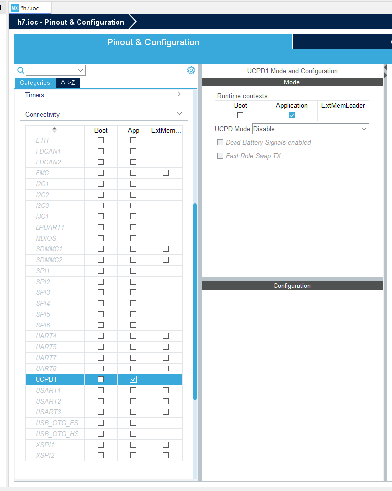

Some pins have alternative functions, see ds pin description.
So maybe you "found out" this on PMx :
---> disable it : set UCPD_DBDIS

Thanks, Yes i see the screenshot, but i am not able find in .IOC file and main.c file.
So you mean where to find it in CubeMX ?
Yes, I am using STM32CubeIDE Can this be disabled from the .IOC file?
If it’s not possible to do so in the .IOC file, please guide me on where I can find it in the main.c file so I can make the changes correctly.
See UCPD1 under 'Connectivity' ?
Thanks, i have find it, i enable UCPD1 in a application, Now it is conflict between UCPD1 and GPIO PM1.
PM1 is configured as push button input logic. please guide me.
@Kaushik1 wrote:
 i enable UCPD1
The datasheet extract said you need to disable it?
