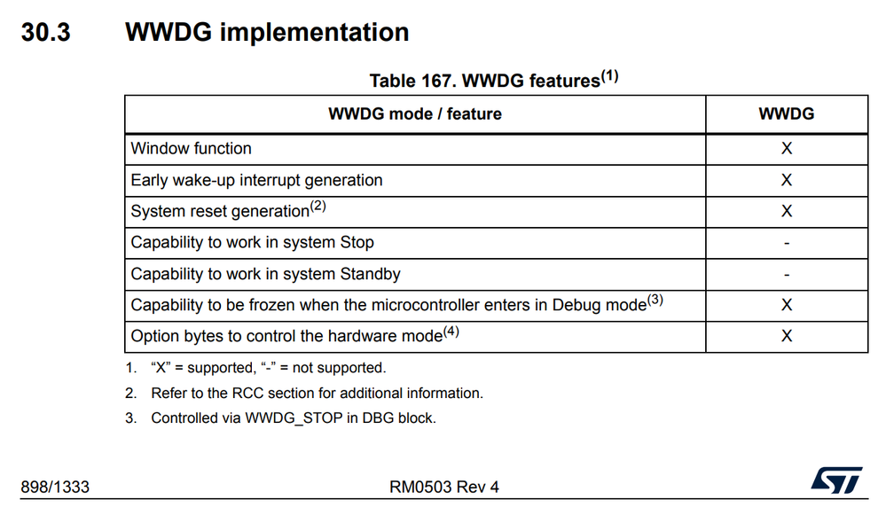

Hi Everyone,
I am facing an issue with my MCU entering low-power mode.
My code works fine when tested separately. I can successfully put the MCU into STOP 0 mode and wake it up through an EXTI line interrupt, but only when the Window Watchdog (WWDG) is disabled.
However, when I enable the WWDG, the MCU seems to get stuck at the WFI instruction when trying to enter STOP mode. It doesn’t proceed further or wake up through the EXTI line Interrupt. The only recovery option is a power cycle.
Has anyone faced a similar issue, or know what might cause this behaviour when WWDG is active?
I am open to sharing the source code.
Any suggestions or pointers would be appreciated!
Best answer by STackPointer64
After investigating, it appears that it is not possible to disable the WWDG without a hardware reset on STM32U0 microcontrollers. This limitation is by design to ensure system safety and reliability. Since WWDG is not supported in standby or stop mode, I don’t think it will be suitable for your use case.

The issue arises because the WWDG is not operational in STOP mode due to the absence of the APB clock. To resolve this, you can either disable the WWDG before entering STOP mode and re-enable it upon waking up, or use an alternative low-power mode like Sleep mode where the WWDG can function.

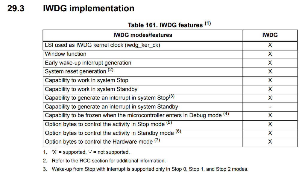

You can't stop WWDG once enabled except through a system reset.
Perhaps switch to IWDG which works in stop mode.
STackPointer64Best answer
October 24, 2025

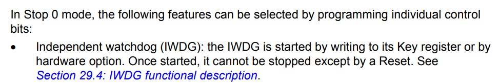

Can I use the IWDG in STOP mode? I see that bit 17 of the FLASH_OPTR register is used to stop the IWDG counter in STOP mode.
If this is possible, could you suggest the necessary steps? Watchdog and low-power functionality are essential for my product.
October 24, 2025
Hello @suresh kumar1,
Yes IWDG can be used in STOP mode in STM32U0 according to the reference manual. But same as WWDG, once started cant be stopped unless by power cycle.
Best regards,
To improve visibility of answered topics, please click 'Accept as Solution' on the reply that resolved your issue or answered your question.
October 24, 2025
Hi @STackPointer64 ,
My idea is to freeze the Independent Watchdog (IWDG) counter in STOP mode so that the MCU will not reset due to the IWDG counter elapsing.
From my understanding, this can be achieved by clearing bit 17 (IWDG_STOP) of the FLASH_OPTR register, if I am right.
As per the reference manual, in STOP mode, the IWDG can be automatically frozen depending on the configuration of the IWDG_STOP bit in the FLASH_OPTR register.
So, the IWDG should not reset the MCU during STOP (sleep) mode, correct?
If both assumptions are correct, could you please share the steps or example code to:
  1. Configure the IWDG to operate (or be frozen) in STOP mode, and
  2. Set up the FLASH_OPTR register appropriately for this behaviour?
October 29, 2025
Yes, that is possible by unchecking the IWDG_STOP option byte in STM32CubeProgrammer after connecting to the board.
As for example code demonstrating IWDG operating in stop mode, there isn’t any for this specific use case. However, you can check the following examples and draw inspiration from how IWDG is implemented in them.
