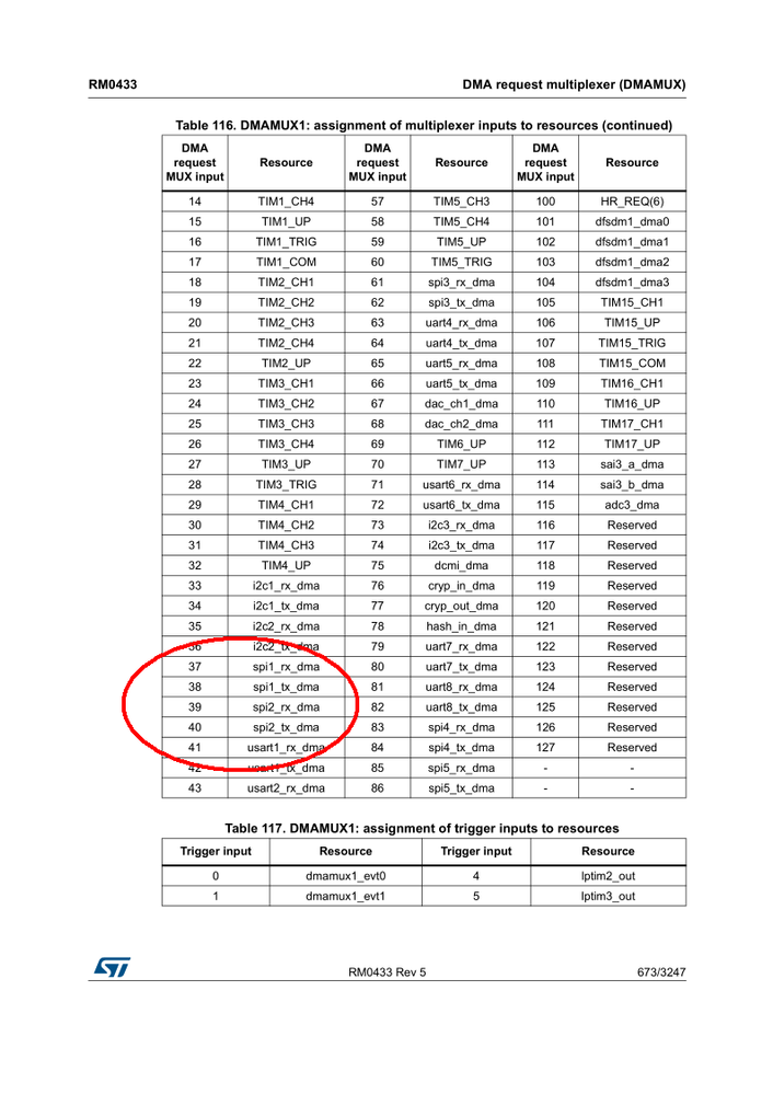

‎2019-10-14 1:34 AM
Dear JW,
thanks a lot for your reply. Following your suggestion, I read the chapter in the reference manual (RM0433) related the DMA for SPI, including chapter 16 (DMAMUX). Checking examples on the "STM32Cube_FW_H7_V1.5.0" package (in details, DMAMUX_RequestGen project) I tried to modify it for SPI using but I still have some doubt about the DMAMUX
In the example I found this code
dmamux_ReqGenParams.SignalID = HAL_DMAMUX2_REQ_GEN_LPTIM2_OUT; /* External request signal is LPTIM2 signal */
dmamux_ReqGenParams.Polarity = HAL_DMAMUX_REQ_GEN_RISING; /* External request signal edge is Rising */
dmamux_ReqGenParams.RequestNumber = 1; /* 1 requests on each edge of the external request signal */
HAL_DMAEx_ConfigMuxRequestGenerator(&DMA_Handle, &dmamux_ReqGenParams);
where the first instruction should be related to the external request (in this case LPTIM2 signal). I serached something for SPI but no label in this case.
Do you know where is possible to find detailed procedure about DMAMUX setting?
The Cube doesn't help.
