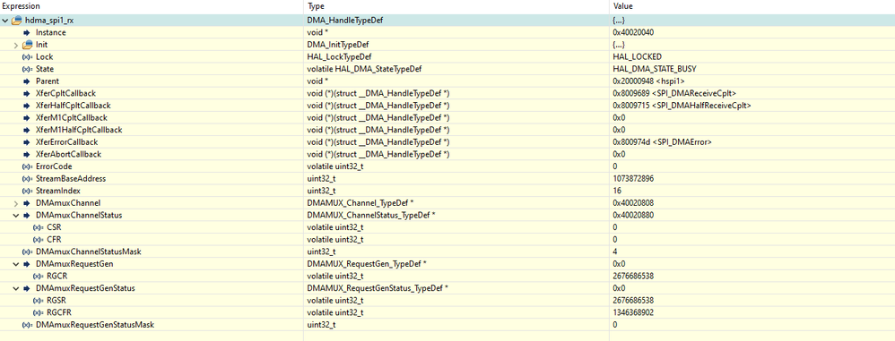

‎2021-01-14 5:37 AM
The SPI is always in "HAL_SPI_STATE_BUSY_RX"
I got this with debugging tool for the DMA Handler
‎2021-01-14 1:54 PM
I mean the SPI and DMA peripherals (and, once you've mentioned, relevant DMAMUX) registers.

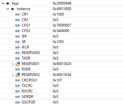

‎2021-01-15 2:34 AM
Sorry, I get it now. I looked register value with debugger tool at the end of the init function:
SP1 :
CR1 = 0x 0000 1000
CR2 = 0
CFG1 = 0x 7000 0007
CFG2 = 0x 0540 0000
IER = 0
SR = 0x 0000 1002
IFCR = 0
TXDR = 0
RXDR = 0
UDRDR = 0
I2SCFGR = 0
I got it from this :
Here is what i got for DMA :
// DMA
CR = 0x 0000 0400
FCR = 0x 0000 0020
// DMAMUX
CR = 0x 0000 0025

‎2021-01-15 3:39 PM
This appears to be much more complicated than I thought. I don't use the H7 and I realized that the SPI in there is much more different from other STM32 than I thought, and I don't understand how Rx-only on this SPI is supposed to work. It appears to me that there's no such mode in this SPI.
In other STM32, once you set Rx-only mode and set SPE, it automatically starts to generate clocks. Here, it appears, that you are supposed to Tx to be able to generate clocks.
