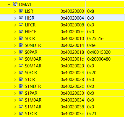

I'm following the SAI DMA example in the project file for one of the stm32h7's. The issue is, no matter what I am always getting a Transfer Error immediately after I start HAL_SAI_Receive_DMA(); I placed a break point at the IRQ_Handler. I am completely confused on what else I need to do.
Things I made sure to do
  • DMA Word Align
  • DMA Increment Memory
  • 32Byte Align Buffers
  • Put the DMAbuffer, pdm, in RAM3
Right now, I'm not even trying to read data, just trying to get the DMA ping pong to work. I know about the cache coherency for when I do need to read the data, but like I said I can't even get DMA to cycle through my main program.

M0AR points to 0x2000'0480, that's not SRAM3 but DTCM. In 'H7, DMA does not have access to TCM. Review you linker script.

waclawek.jan
Read out content of relevant DMA registers when in there, and post here.
Also, if the transfer size (incorrectly called "alignment" in the DMA init struct) is word, why do you have uint16_t as the buffer type? IMO it overflows the buffer, but that shouldn't cause DMA transfer error.
0693W00000ANnHlQAL.pngIs this what you wanted a picture of? Or were you asking for something else? I can expand them and retake if need be.
Because I goofed and misread their example, I originally had it the same size of the buffer but I must have misread theirs when comparing. I just retested it and its still broken.
Wait, is it because of S0M0AR? I thought me doing the alignment and attribute would prevent the peripheral from placing data at location 0x2xxxxxx. Why is it not taking the place of SRAM3?
I completely understand this, but I thought doing the ALIGN_32BYTES (uint16_t pdmBuffer[AUDIO_BUFFER_SIZE]) __attribute__((section(".RAM_D3")));
would make sure to correct this. I've never messed around with the linker before, do you have any documents?
Also thank you very much, I appreciate you helping! Normally I wouldn't be this sloppy, but I thought that error would have been taken care of with the above statement
