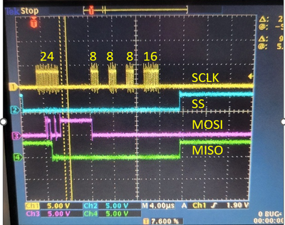

While walking through the code and following it on my scope to see the SPI Bus timing I am seeing something that does not make sense.  The AFERead32BitBuffer() function is called when you read a 32-bit register from the SPI Device which is an Analog Devices ADE9430 Chip (see Below).

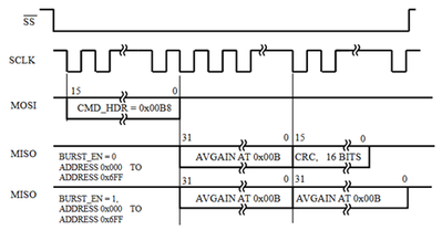

  1. The code calls HAL_SPI_Transmit() with the number of bytes it needs to transmit (see line 9 below). In this case it is transmitting a two byte command header where bits [15:04] are the register address and bits [3:0] is the R/W command, see example timing below.
  3. When I capture the actual timing, I would expect to see a 16Bit transfer of the command header. instead this is what I am seeing.
    • Timing shows a 24 bit transfer which I believe should only be the 16 bit command header. Instead it appears the SPI bus is starting to immediately read the first 8-bits of the 32bit data riight after sending the command header.
    • This is followed by the next three bytes of data to make up the 32 bits.
    • Then finally the 16bit CRC is returned from the ADE9430 Chip.

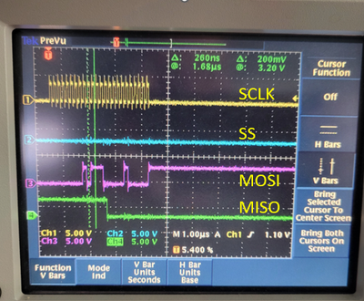

  5. Next I wanted to only execute that single line so I added a breakpoint on this line 9 and single stepping over it while capturing the timing on the scope (see timing below). I would expect to only see two bytes transferred on the SPI Bus after its execution. Instead, I always see the timing for three bytes, even though line 9 clearly says transfer two bytes.  This was the only line of code that was executed.
    I am trying to understand what is causing the SPI Bus to generate the timing for this third byte when the code is only transmitting a 2 byte command header.
Thanks - mike

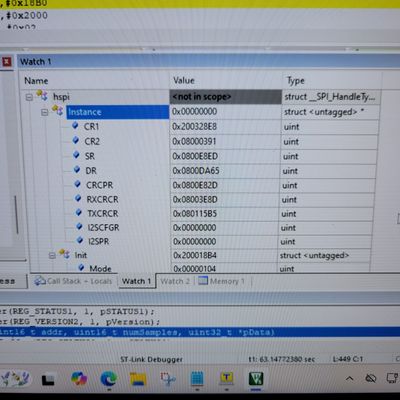

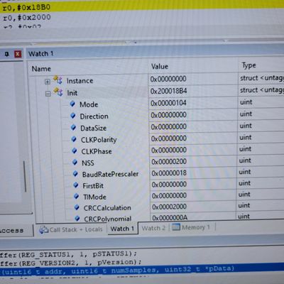

The SPI Clock is running at 6.25 MHz here is the contents of the hspi structure which I think has the SPI Configuration information. If not let me know what I can provide.

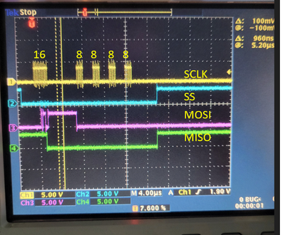

I took a picture of the same read with CRC is not enabled it looks to be what I would expect. The command from the processor to the ADE9430 is a 16bit wide command. Followed by four 8 bit transfers which make up the 32bit register data.
I just can't figure out how and why it is sending the 24bits as a group when CRC is enabled and the code indicates send 2 bytes.
