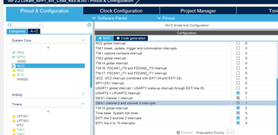

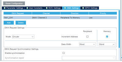

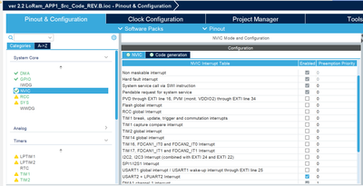

Our objective is to measure the frequency of an incoming signal using TIM1 in Input Capture mode with DMA (Channel 2). Below are the key configuration and issue details:
We are interested in capturing frequency using DMA mode without any interrupt callbacks. We need a way to synchronize the transfer completion to ensure the captured data is correct
i have Attached timer settings and code snippet
  1. Timer Configuration:
    • Timer: TIM1 (16-bit)
    • Clock Frequency: 64 MHz (no prescaler)
    • DMA: Used to capture values without interrupt
    • Slave Mode: Reset mode with trigger on TI1FP1
  2. Input Signal:
    • Frequency Range: 15.8 kHz to 16 kHz
    • Signal Period: Approximately 62.5 µs to 63.3 µs
  3. Observation:
    • When checking the DMA_ISR_TCIF2 flag before reading, the time between frequency measurements varies inconsistently — sometimes 1ms, 2ms, or 3ms.
    • However, if we remove the DMA complete flag check, the capture reads occur at a rate matching the system clock and signal input, i.e., much faster and more consistent.
      The Issue:
      We are confused why adding this DMA transfer complete flag check:
      if (!(DMA1->ISR & DMA_ISR_TCIF2)) return 0; DMA1->IFCR = DMA_ISR_TCIF2; // Clear flag
      results in millisecond-level delays between readings, even though the input signal is at ~63 µs intervals. Without this check, data comes in faster, matching expectations.
      avinpat_8_0-1749719404641.pngavinpat_8_1-1749719421732.pngavinpat_8_2-1749719481921.png

Because the flag is checked and cleared within the HAL_DMA_IRQHandler. You should leave it alone, or you should remove the call to HAL_DMA_IRQHandler if you want to handle it yourself and implement your own handling of the flag.

Hi I have just provided below a reference flow will it be ok or should I need to change anything else
DMA flags need to be checked and handed within the IRQ handler, otherwise it will continuously re-trigger. Interrupts are enabled within HAL_TIM_IC_Start_DMA. You can disable interrupts after calling that, and wrap it all within a __disable_irq/__enable_irq, if you don't want interrupts to be called.
