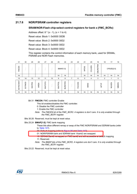

‎2025-06-23 10:35 AM
Currently, I manage to make it work but it's not the way I thought.
I had to change the bank address to 0xC0000000
and deactivate MPU.
I can see one write cycle and my device is now working as expected.
But I'm not sure it's a good idea to deactivate the MPU.
I later found this related thread :
By the way, it's sad that cubeide didn't warm you about the bank remapping needed in 16 bits mode needed for sram/nor/lcd..

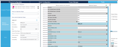

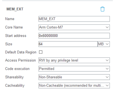

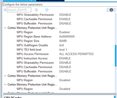

‎2025-06-18 1:04 PM - edited ‎2025-06-18 1:17 PM
Either I don't know where to search for this option, either it did not exist xD :
Edit :
I also try to deactivate the MPU without success, I still have 4 write cycle.

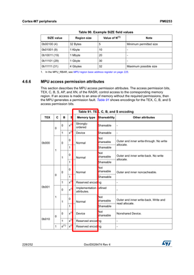

‎2025-06-18 10:27 PM
I don't use CubeMX and have no idea how those clickable things translate to the MPU settings, sorry. Maybe somebody more versed in Cube/CubeMX will chime in.
(I should have written "Normal" instead of "Memory" above).

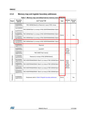

I don't know which 'H7 you are using, so I looked into RM0433 (for 'H743 and kin) and there's an option to remap the SRAM/NOR area of FMC to a different address, which is by default set to Device:
The remap in the 'H743 is accomplished through setting the FMC_BCR1.BMAP bitfield
However, if you apply MPU settings onto a memory area, its those MPU settings which override the defaults, so here you would perhaps want to do only the remap without using MPU at all.
