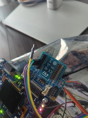

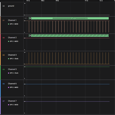

I connected a logic analyzer and here is an image of this :

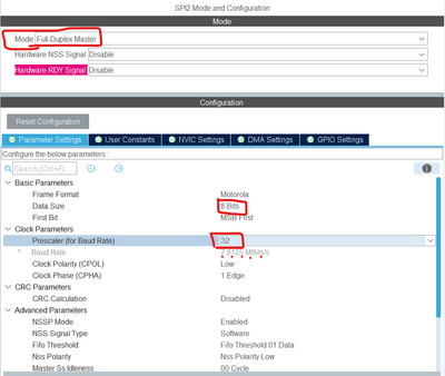

Solution for getting SPI2 to work:
I created a new project from the stm32cubemx, and my first setup was to only setup spi2.
I set the Data Size to 8 bits (can keep at default of 4 bits just update the logic analyzer setup) and the prescaler to 32 (which sets the baudrate to 7.8125 MBits/s)

  • Setting the prescaler to 32 -256 works great no issue, however when setting to a smaller value nothing transmits.
    • would like to note that C is detected in the image below which is not expected (I will need to check if this is due to also using SPI5).
  • In the same project I tried to setup spi5, however regardless of the prescaler value nothing would transmit over the lines.
  • An image of the output for both spi2 and spi5:

Original situation: I have the logic analyzer connected to the devkit and I am using the stmod+ extension. Image added at the bottom.

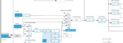

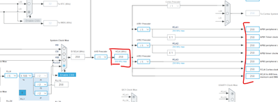

For Future Reference: SPI2 is good to use with this settings and to Avoid using SPI5
Make sure Clock speed is 250MHz and peripheral clock speed is 250MHz

These are the configurations for SPI2: Mode Master full-duplex
  • set the datasize to 8 bits and prescaler to 32 to have a baudrate of 7.8125 MBits/s
